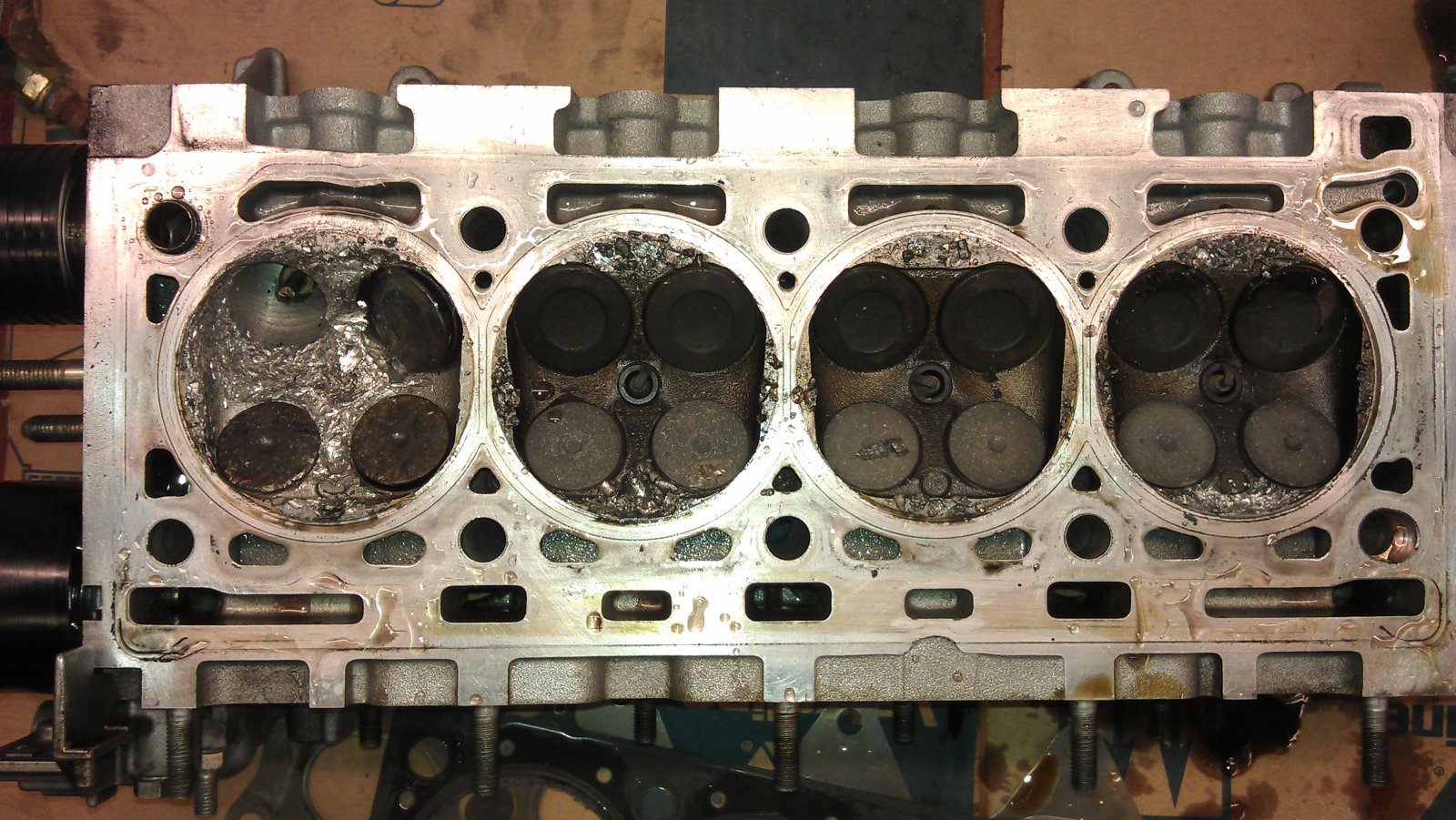

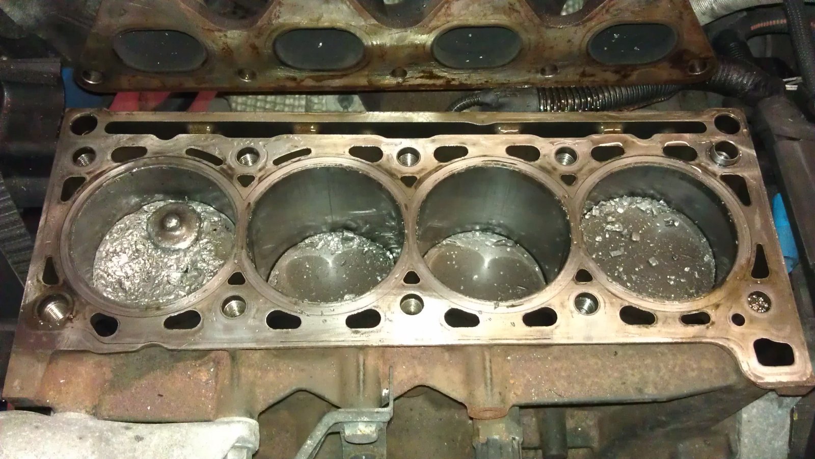

Your top and bottom end have gone if the valves have snogged the pistons.
I would buy a good engine off here with belts done and get it fitted, if your belts needed doing then just regard this as your belts being done cost wise.

Is it likely to be both the top and bottom end from what you can see in the thread? I honestly have no idea what I'm dealing with. I've seen recon/new top/bottom ends on Pure Motorsport but they are bloody dear. If I need both I'm especially screwed price wise if I go down that route.

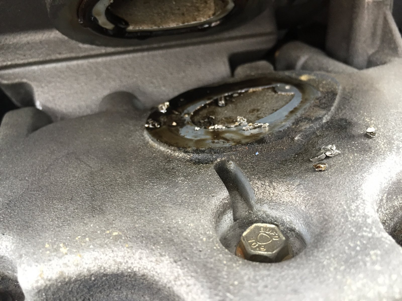

That was at the top of the inlet - will that be part of a valve or something else? Something flew out of the exhaust I think as well, would that be one too? 🙈

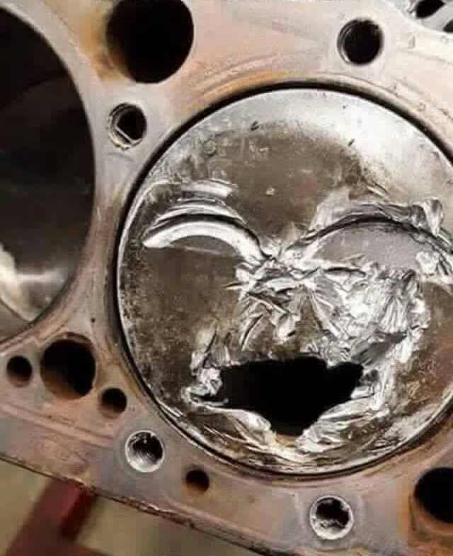

If thats bits of piston that engine is seriously fubared! Personally id be going recon engine, possibly 2nd hand and rebuild it myself, im fortunate tho as im a mechanic!
I'm only just realising that now! It's weird though as it did a 500 mile round trip that day and performed faultlessly. Then about 4 miles from my house it just went boom :grin:
