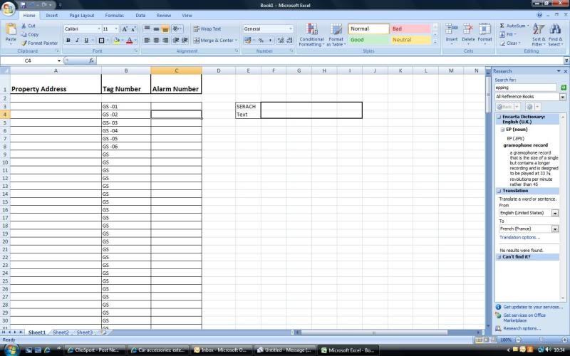

Hi Guys.
This is a pretty basic sheet but I need to know if the following is possible. I need to search the columns A & B (If it can only search A then that’s not a huge problem) there will be addresses such as "Victoria House" in the column A then they can edit a key tag for column B.....As we hold around 100 keys per office I would need them to search (I cant put them in alphabetical order as its already mixed up and I have to manually resort them each month lol.
I put a mock box where I would want it to go but need to know if I can code/link it to search?
I know I can press CTRL + F but I’m not sure the staff could manage that. lol

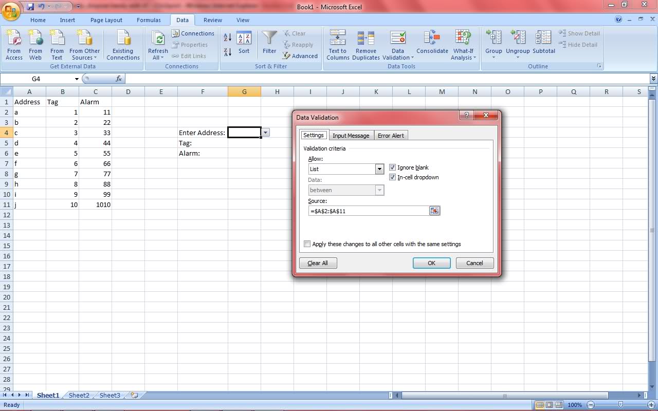

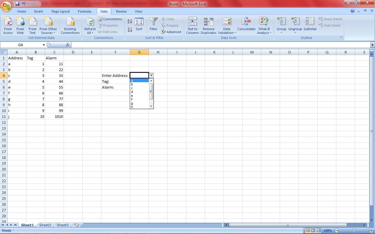

Step 1: pick the cell where you want to enter the address and go to the data tab.
click on data validation, then data validation again.
from allow choose 'list' and then in source click that little button and highlight all your addresses.

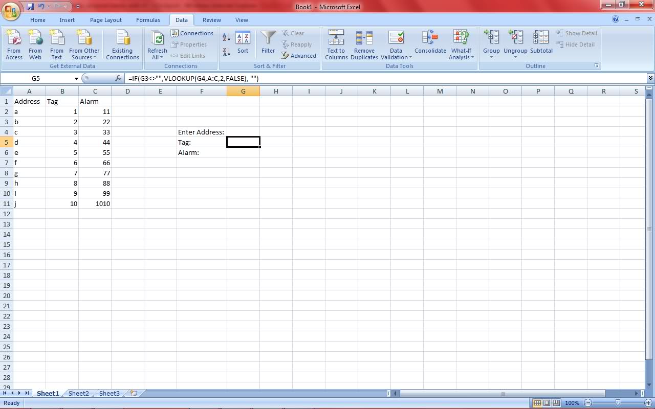

step 2
write a vlookup formula -
=IF(G4<>"",VLOOKUP(G4,A:C,2,FALSE), "")
if(G4<>"" -> that means if the cell with your address isn't empty (because if it's empty it comes up with N/A which is untidy)
VLOOKUP(G4 -> do a lookup on what is in that cell
,A:C -> compare with whats in A:C
,2 -> retrieve what is in column 2 of A:C
,FALSE i think this means exact match which you want because of the validation you created...
step 3, select an address and see how you get on ;)
