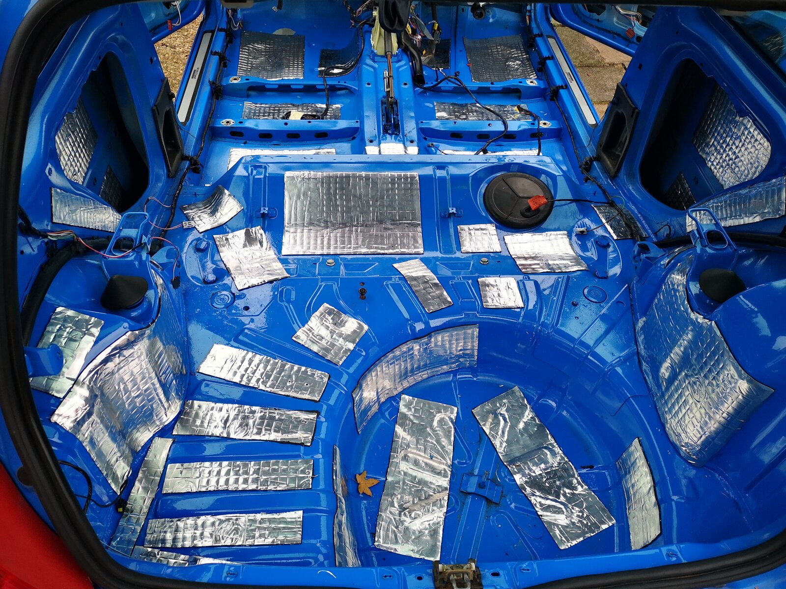

Around 20kg of silent coat sound deadening.. I then put a full coverage of closed cell foam over before putting the interior back in as the closed cell doesn't really weigh anything.
Didn't make as much difference as I'd hoped but still an improvement, wouldn't say it was worth the effort though.. Better to just accept a clio will never be a particularly refined car lol
