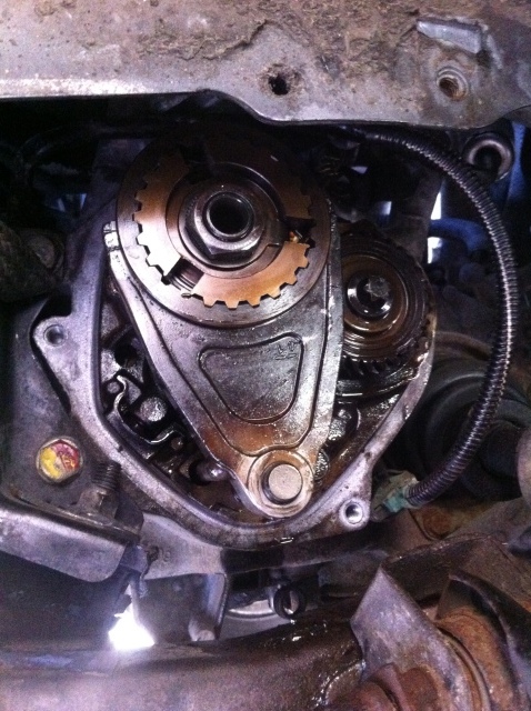

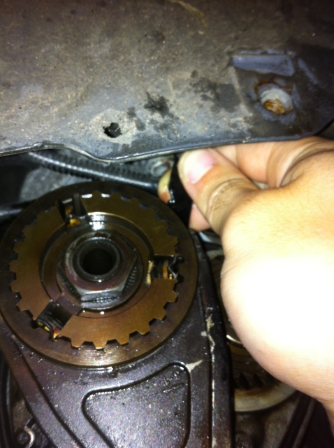

Right then boys, I've got the cap off. Any idea what I should be checking here, looking to tighten etc?
There seems to be what seems like metal shavings in the cover, not loads but enough to notice if you run your finger on it, and my dad thinks he just got a lump of plastic out of it from somewhere.
This was where the bit of plastic came from
No idea what that is but it has a fair bit of movement. The big panel around the sprocket rotates side to side a few mill, dont know if that normal, and that panel was what was a bit gunked up, especially the two grooves on each side at the top. I tightened the bolt but it seemed to be moving the whole sprocket so I guess it was tight enough.
Assuming it's f#cked?

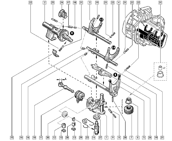

Right so I got in a mard trying to get the cover back on and have yanked part of the gearbox halfway out and can't get it back in again. The big piece on the rod, part 5 on this diagram, I'm guessing it's fifth gear selector or something?
It just pulled 2/3rd's of the way off of it's cog and I can't get it back in place for some reason which is weird considering how easy it slid out. Any tips? Can I apply force to it?
