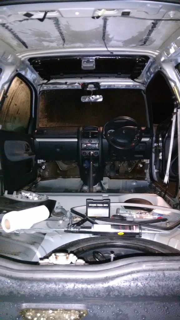

Had wet carpets one minute, next minute

Nope. Only joking yeah, bloody sunroof pouring in. It was one of them looking up the bulk head for ages, had the scuttle off ect then looked up at the roof and thought, that looks wet lol

I pulled my interior out as I'm replacing it, but wanted capets and foam up anyway to dry off, while doing that found a previous owner had drilled holes in the floor to drain the water!!!!!! What a clever guy. Took the whole roof lining down so I can dry the lining out and get as much water out the roof as possible. It's a bad leak, and I always do what I clas as a proper job, not knocking what you did, just I'm a little ocd with everything I do.

Cheers mate, always like to think I'm doing it the best I can. But after today I'm beginning to wish I hadn't bothered lol. I had some double sided seal in my garage so I used that, hasn't worked :( so going to use a weather proof sealant. Didn't want to bond it, but at least I know it won't leak. So another day not getting the new interior in.

I went to b&q, wickes and another small hard ware store looking for something like that but found nothing suitable. It's really pissed me off as I hate doing anything twice.

The reason I didn't want to go genuine is they are proven to fail and leak. When I scraped the original seal off it did seem poor. As @fairm010 said its also a lot of money. If it was a good seal and I had faith in it I'd pay it, but I have no faith in the seal. Glad its worked for you though
