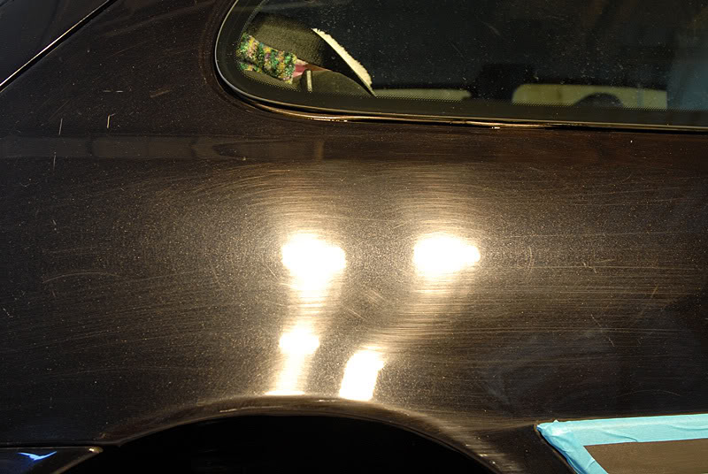

I decided to polish my Mums car, partly because I wanted to practice, so I would fuk my car up when I did that! But mainly because the condition of the paint on my Mums car is awful! There are TONS of really bad swirls, I think the previous owner used a scouring pad to clean the car!
I used Menzerna polish (final finish PO 106 FA), and the menz polishing pad.

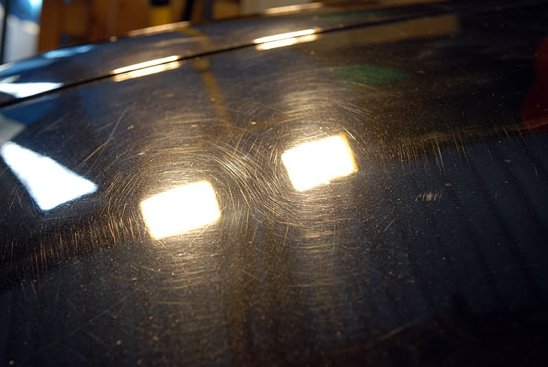

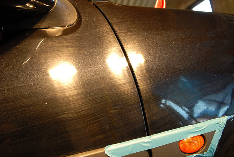

One thing you will notice is that although the majority of the swirls are gone, there is still, in places, a lot left. This is because I was using a non-abrasive polish. I think the final finish polish is designed to take very minor swirls, and in my case there were a lot of deeper swirls.

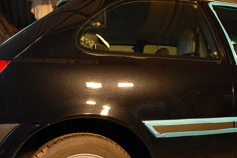

Before:

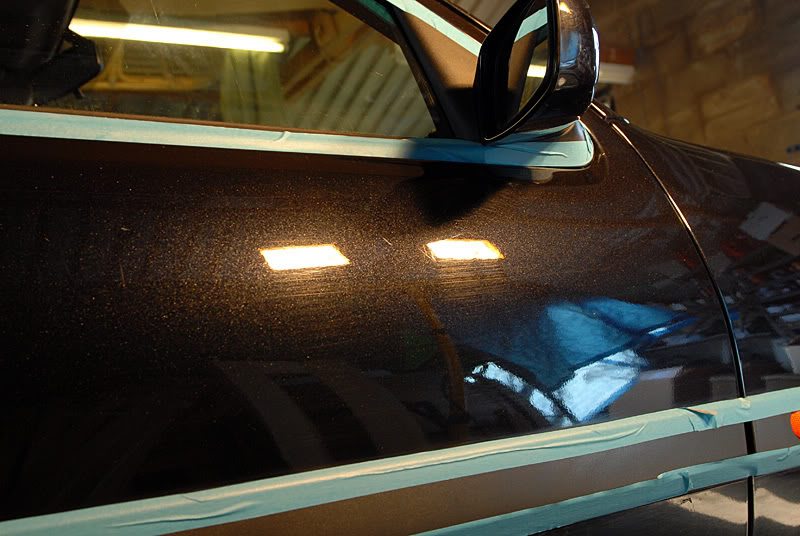

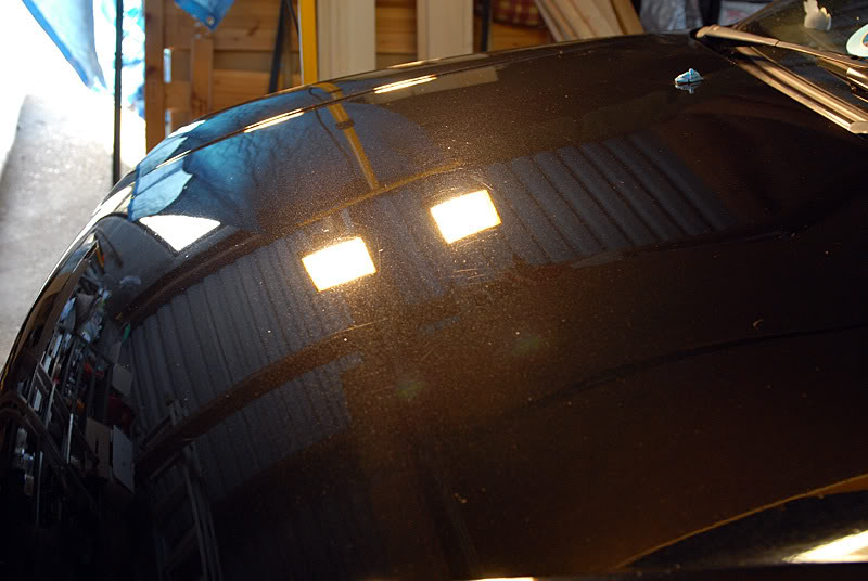

After:

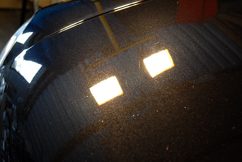

Before:
After:

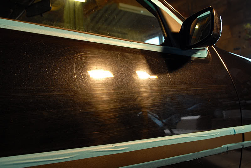

Before:
After:

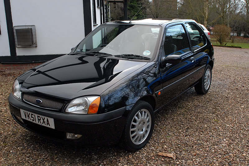

Final:
Im very happy with the results, especially for my first try! If I was using a more aggressive polish, I'm sure the results would have been even better.
I was quite surprised by how 'richer' the paint looked. It actually looks metallic black instead of a crappy matt black!

Yep, your rite, the final polish is there just to take away miror defects, it has a very light cut, to bring out the gloss in the paint. I wouldnt have bothered with the final finish, stright to the power polish on them swirls and then with the final finish. Did you seal the paint aswell?

I find 106FA does have a decent amount of cut, although it does take time to break down.
What sort of process were you using? For paint in that sort of condition i'd usually go straight to something like an sfx-1, which would give you a better cut than with a polishing pad.

Good effort matey, you will find that once you use a polish with a good cut the swirls will go and will have a near perfect finish

Nice results, using some intensive polish would have sped things up a lot on swirls like that.

I'd have hit that with Intensive Polish on a yellow pad, followed by Final Finish on a white. Works well that combo :)

On a car that age removing all RIDS is impossible without wet sanding.
Nice results tho!
