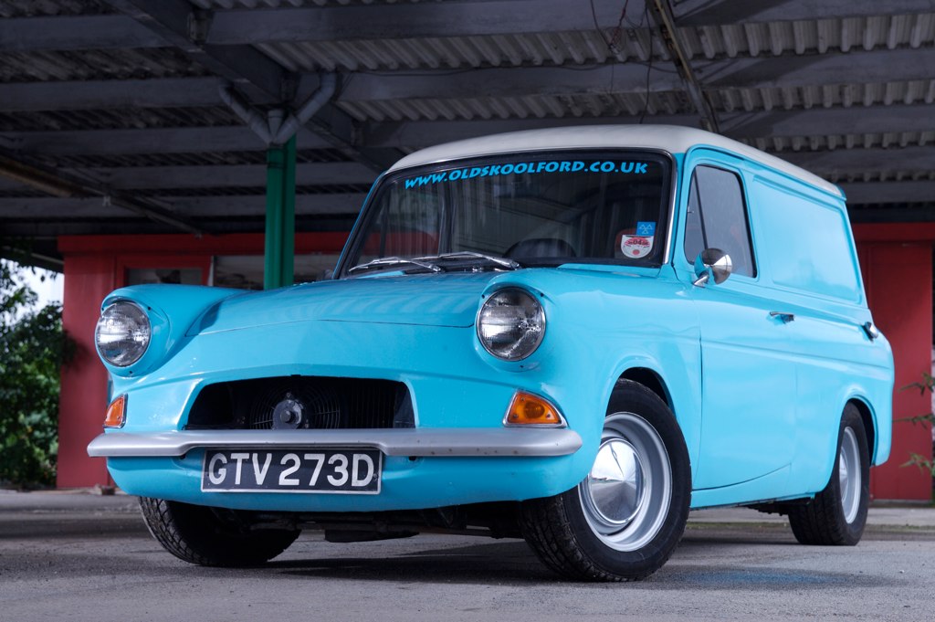

And I'm in love. So much classic Ford win here...
http://www.wheel-*****s.com/forum/viewtopic.php?f=43&t=18291

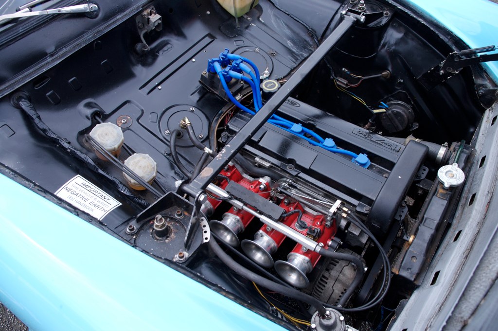

Here's the spec.
1966 Ford Anglia Van
2 litre Mondeo Zetec
Jenvey throttlebodies
Megasquirt ECU
2000E Gearbox
3.54 diff with Quaife ATB LSD
Link bars and panhard rod to locate the rear axle.
Modified Classic Capri struts with coilovers and adjustable track control arms.
Double anti rollbar.
0-60 in 7 seconds. 153bhp or 203bhp/tonne.
