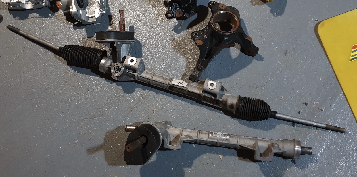

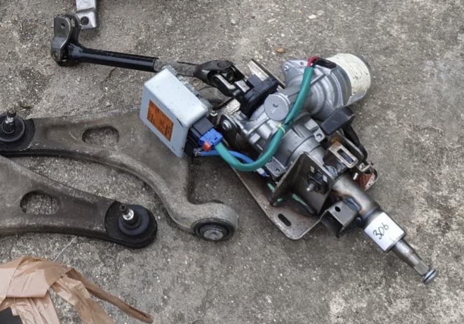

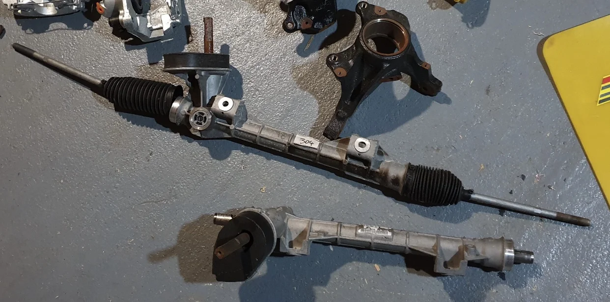

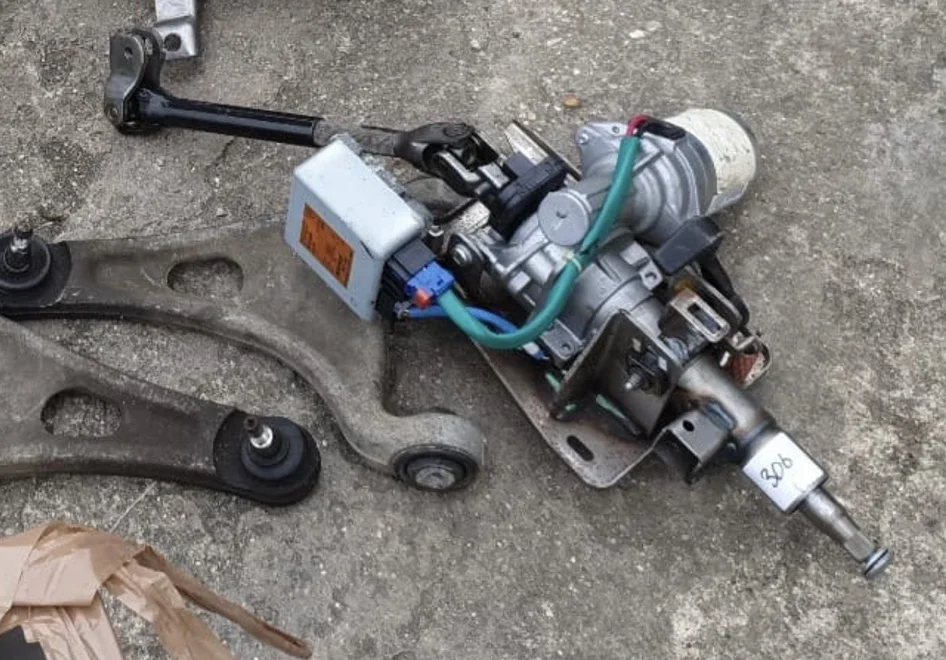

I’m trying to read up on it but don’t understand what’s involved really
Basically the steering rack and column off an epas equipped car along with the adjuster unit. Then the eBay for the ecu control box
We’ve got all that from a Twingo RS, reckon it’d work?
Dyou reckon it could be done then?
But then you have the mounts that are different. If whatever reason you had the outer shell of a clio column, you could swap that over to the twingo one (I think) But then you might as well just get a clio column, the lower uj on twingo is the same fitment as clio so you only need upper part of column which are pretty cheap. And Im not 100 that the ecus are interchangeable

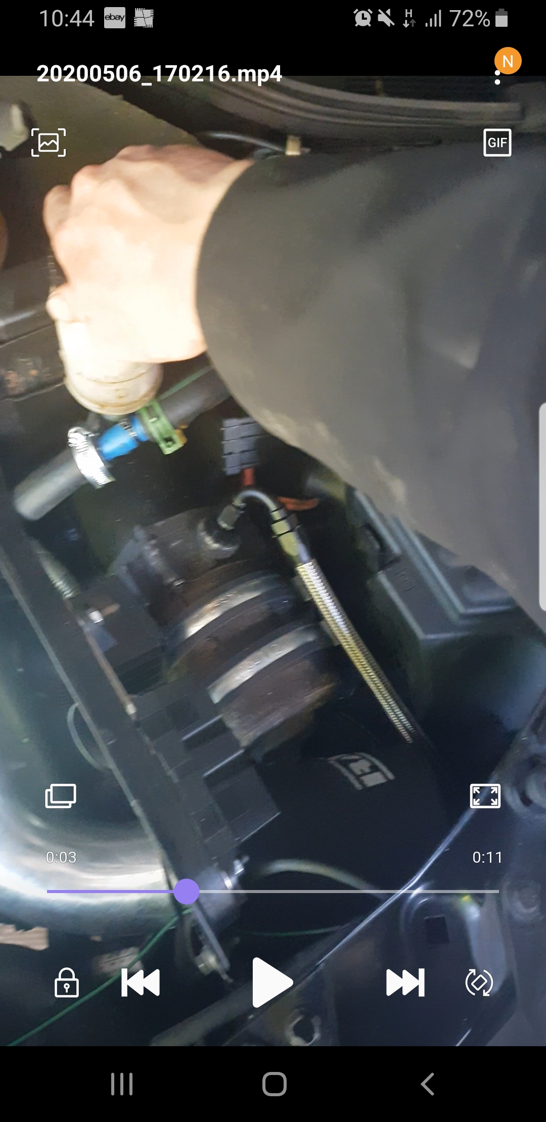

It's quite involved. My pump sits where the standard battery would go. So the battery is now in the boot. You would need to make a bracket to hold the pump as well.
I used the standard low pressure return hose and an AN hose for my new high pressure line. I also have a cooling loop from an mx5 behind the front bumper but it's probably overkill.
The advantage is you reduce the rotational demand on the engine like an EPAS conversion, but the steering feels exactly the same as standard.
I don't have any photos of the final fit but heres the mockup, it's all hidden beneath a cover anyway. 😊
