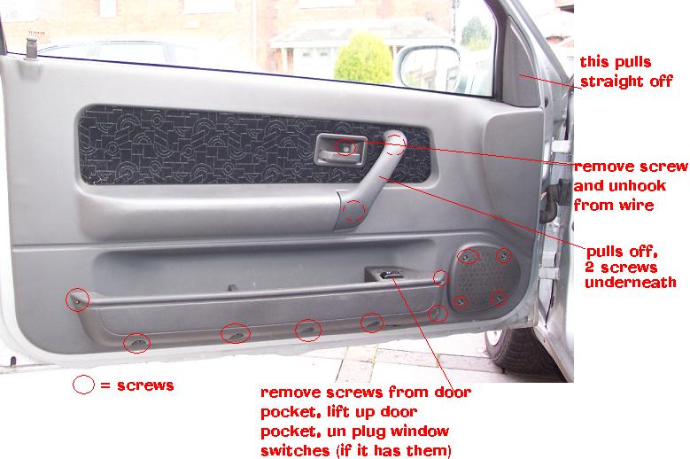

Hi any1 know how to take driver door card of a 1996 clio? Should it just pop of or is there screws involved?
Any help appreciated
Murray
after u have removed all the screws, there are a few 'pop' type clips near the bottom of the door, just give it a tug, might be some black sticky s**t on the door card too, after its free, push the door card up out of the window rubber.
