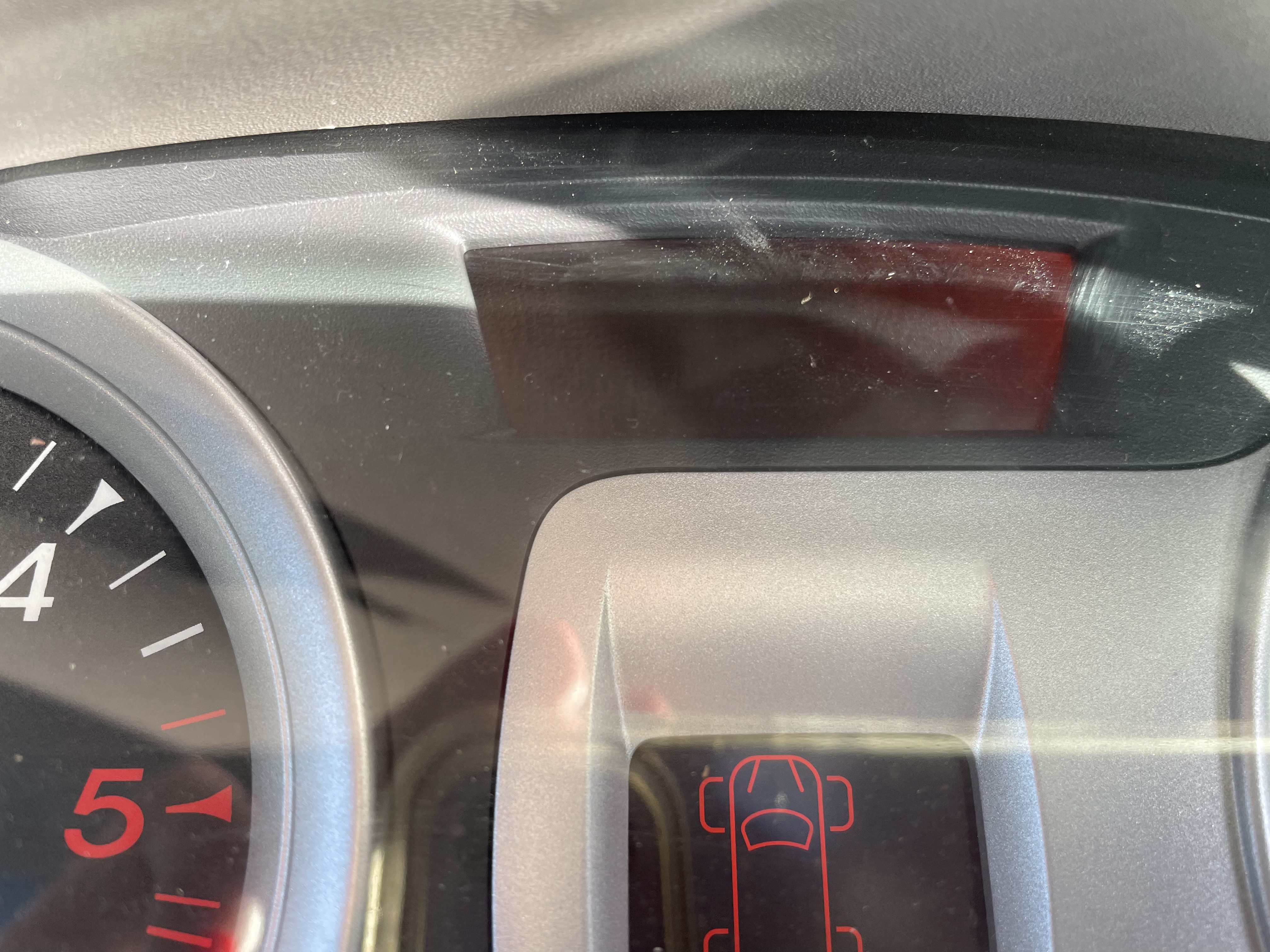

Help needed please
Can anyone tell me how I can get
this to light back up please ? Thank you

Its a 20 minute job removing the dash clocks on this, you just have to pry away the black plastic cowling that surrounds the clocks and then unscrew the few bolts holding the dash clocks. You can then take the dash clock apart and see if there is anything obvious causing it not to light up the LCD.
Worst case just buy second hand mk3 clio dash clocks off ebay with a similar mileage and just replace it.

Try pushing on the cluster quite hard.
Might need a dry solder joint fixing though.
