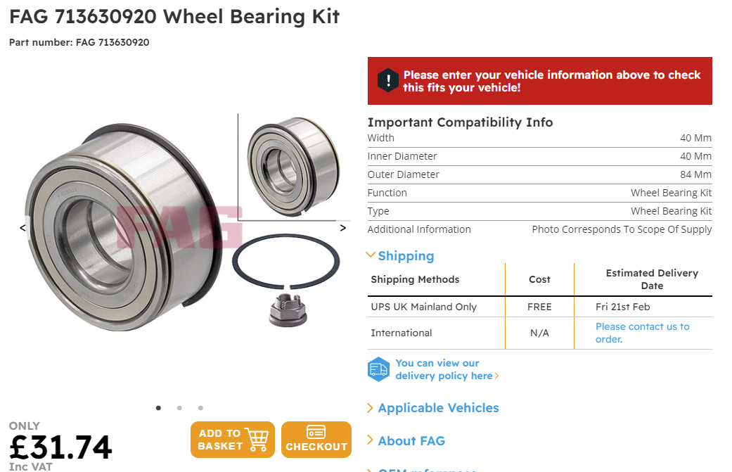

Unfortunately, the rarity of the car translates into rarity of parts! The car requires a new front wheel bearing, and we took the old one out, and it measures in at 40mm inner diameter, 84mm outer diameter and ~40mm width.
Now, the problem is that I can't find a wheel bearing with these exact dimensions. The 172/182 non-cup bearings are available, but obviously won't work. After a lot of searching, I found a bearing for a Renault Laguna that is 40x84x38:
According to a forum post on here a while ago, that is the correct dimensions for a 182 Cup front wheel bearing:
Also, this one on Autodoc was linked to on the forums by someone who said it is correct, despite it being 39mm tall:
I'm not sure however, as my old wheel bearing is slightly taller, and I'm concerned that the bearing won't stick out enough at the front once pressed in for us to put the circlip through. If anyone knows if a 40*84*38mm wheel bearing will work in my car, please let me know. I'd rather not import it from Europe/UK, obviously due to price, but also because the car needs to have its roadworthy test done very soon, and I can't wait for weeks or months for the parts to arrive.
  Titanium Clio 182FF
The SNR bearing is correct OEM item.
I went for a FAG 713630920 if that helps at all, wanted an SNR, but was hard to get hold of at the time. No longer have the car, but no issues.
Thanks, but I doubt I'd be able to get either without going the import route. Would either of you say 38mm depth is wrong? I know it's only out by 1-2mm, but like I said, I'm afraid the circlip won't go on when pressed in, and I doubt they would accept returns once it's been pressed in and out if it doesn't work 😂

The FAG I had fitted is listed as the below, so I can't say if the 2mm would make a difference, but I'm not sure I'd risk it.

This is the correct wheel bearing.
