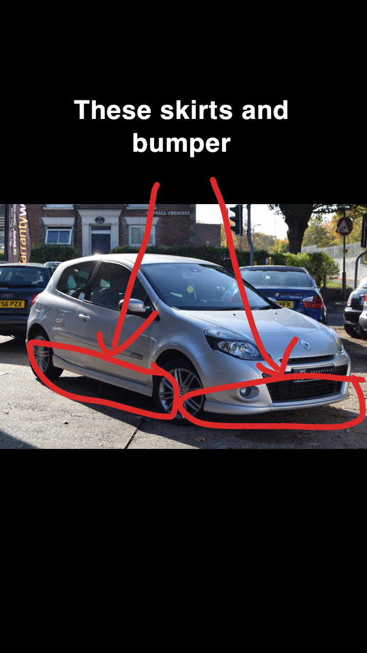

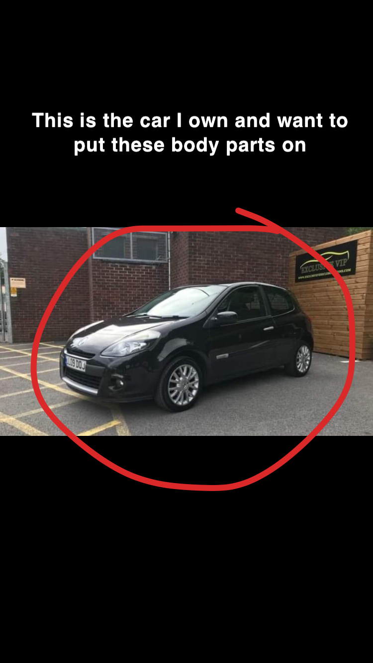

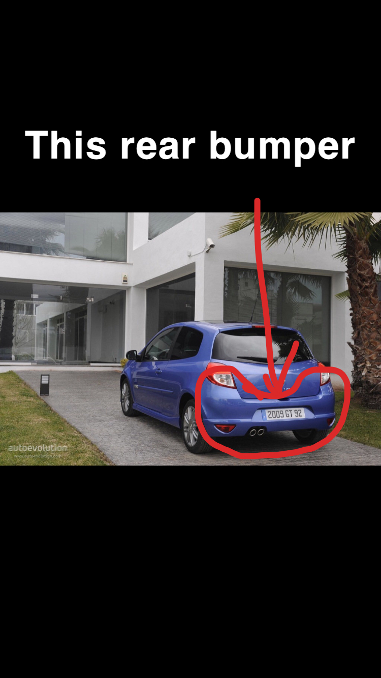

Hiya everyone just wondering if you can put the front bumper, the skirts and the rear bumper from a 2009 Clio gt on a 1.2 2009 Clio 16v dynamique?

Yes they should fit, but there are 2 different types of wings for the MK3 clio. 185 and 195 wings (based on tyre/wheel sizes)
If yours is the Dynamique then it SHOULD have the 195 wings that will match up with the GT bumpers :)

Thanks so much, very sorry on the reply but this helps a lot!
