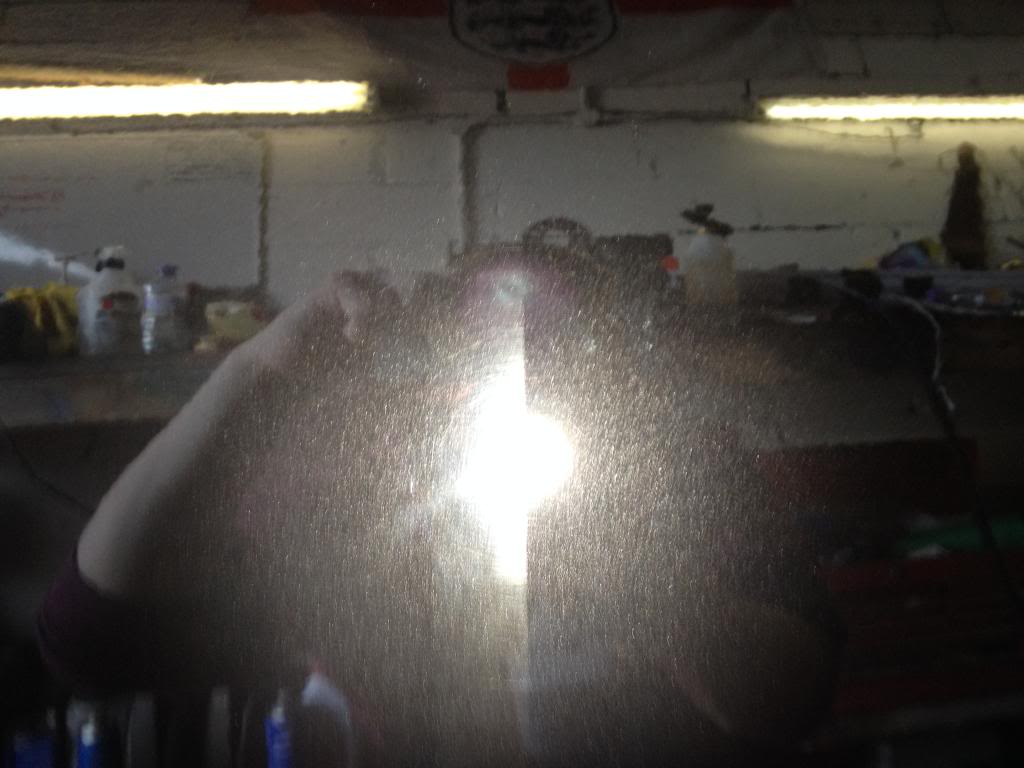

So yer, swirly...
Swirly! by scrooge89, on Flickr
Fixed and a 50/50
De swirled by scrooge89, on Flickr

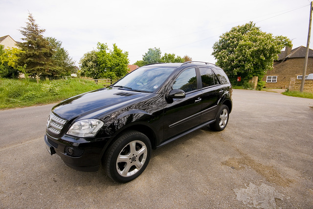

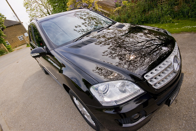

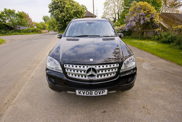

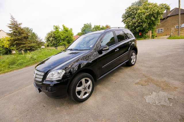

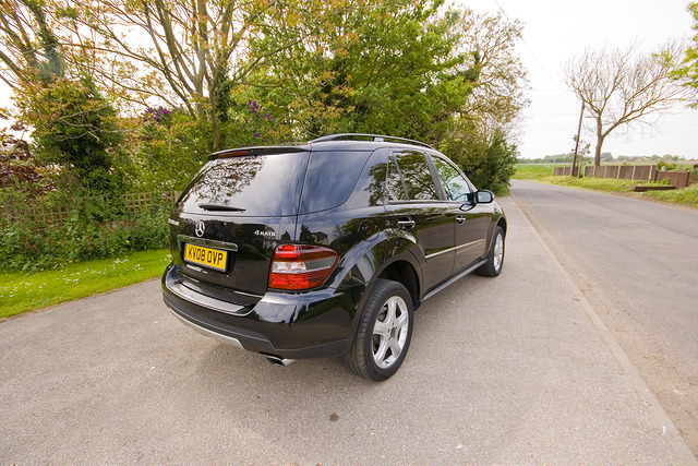

Wasn't the hardest paint so I got fairly good correction, it certainly looked 100% better than it did before :)
ML. by scrooge89, on Flickr
ML.. by scrooge89, on Flickr
ML... by scrooge89, on Flickr
ML.... by scrooge89, on Flickr
ML..... by scrooge89, on Flickr

Thanks :) Menz 3000 and Hex white mate
I wanted something that would do some decent de swirling without needing refinement after and it did the job.
