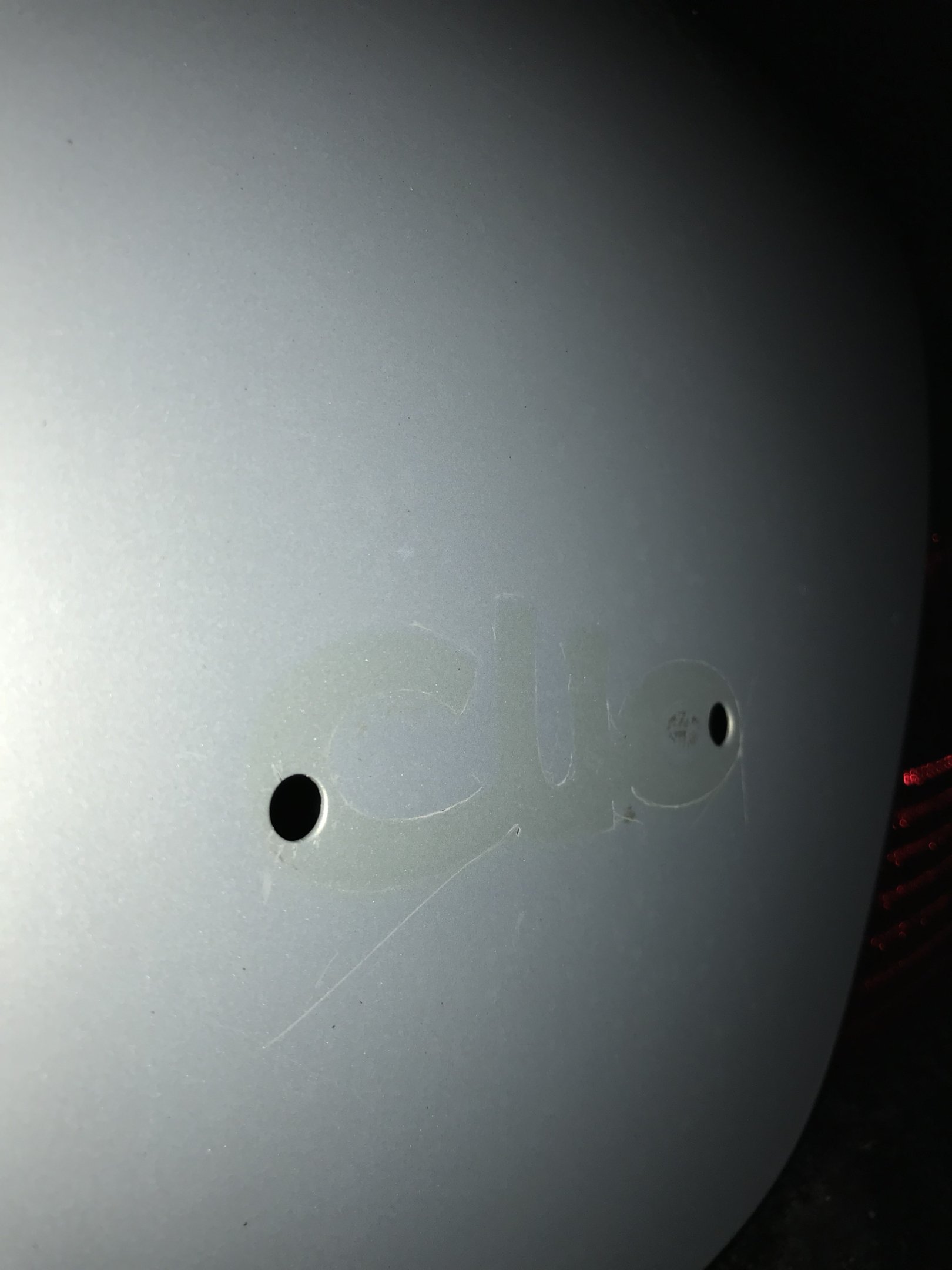

Hey there! I’ve only had time to come here now, so here’s the current state of the back of my car. Also, the picture was taken during the night but i think it’s visible!
But right now I’m really thinking about buying the pins, spraying the badge with PlastiDip and putting it back.

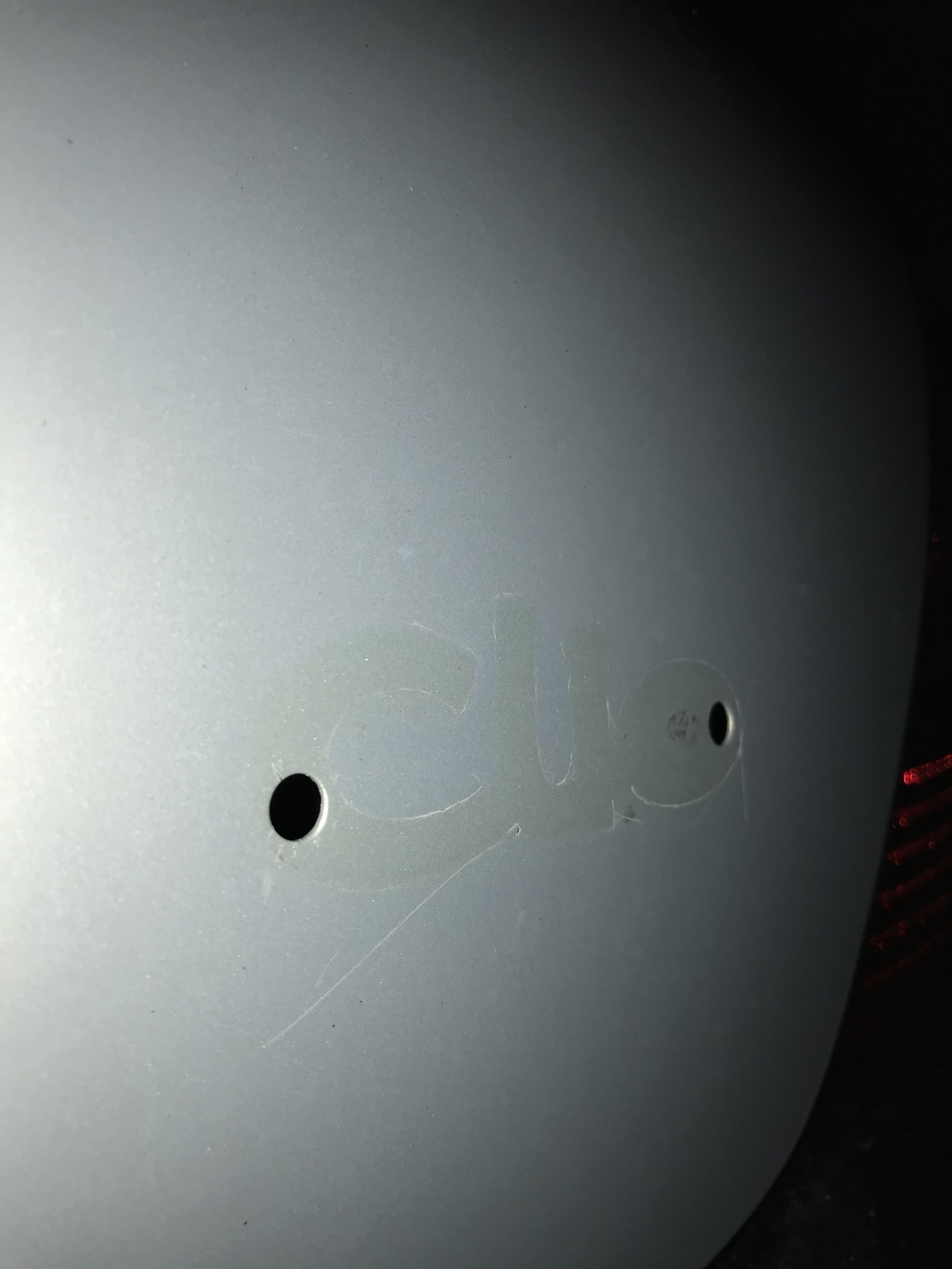

But right now I’m really thinking about buying the pins, spraying the badge with PlastiDip and putting it back.View attachment 1386738
Looks like glue residue to me.
Get some tar remover on it
  Ph2 172, 106 Rallye
As above, tar remover will get it off. Don’t scrub hard though as you’ll mar your paint.
  Ph2 172, 106 Rallye
Yeah it certainly looks like adhesive.
You’ll know straight away when you run you finger over it, if you can feel resistance or anything mildly sticky, it’s glue.
Give it a good polish with something like AF tripple afterward and it should be grand.

Well I tried applying tar remover and then polishing it again but it just won't come off. I don't think it's glue anymore, but it's okay, I've ordered the pins and I'm going to place the badge again, but I'll paint it black.
Thank you all for your help!
