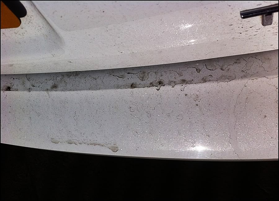

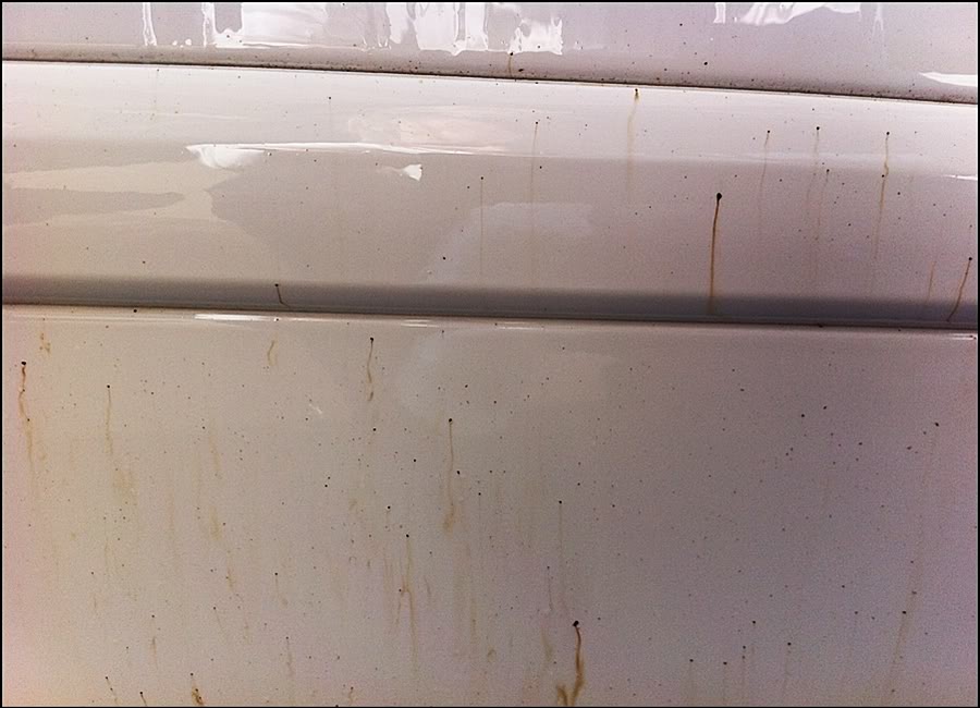

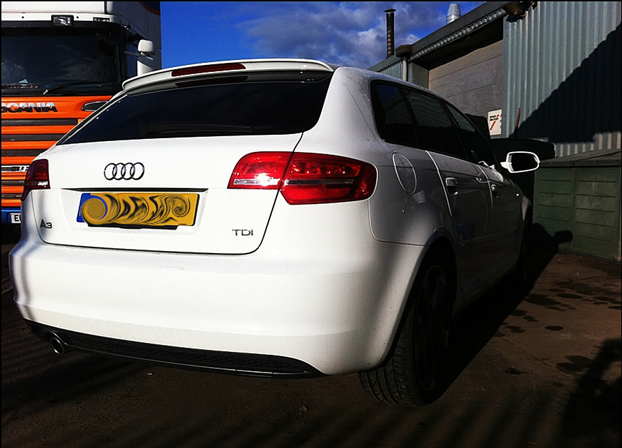

Car arrived with some general travel dirt, looking at Mikes Leon I can tell he looks after his cars. This one was straight from the dealer really...

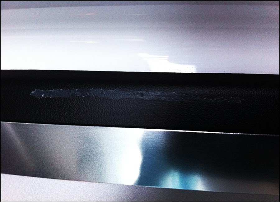

Oh and some awesome dealer prep... Tape residue everywhere...

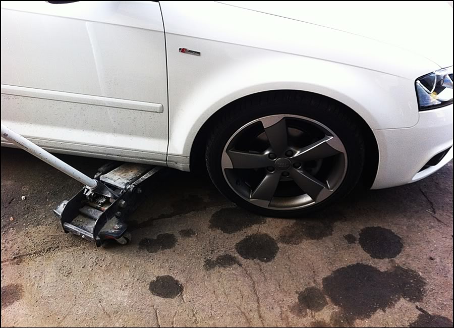

First up wheels off and cleaned, AB Britegel still my favourite cleaner and couple of pics of Wolf's De-Ironizer doing it's thing...
Not too bad considering how bad the wheels were with brake dust pitting.

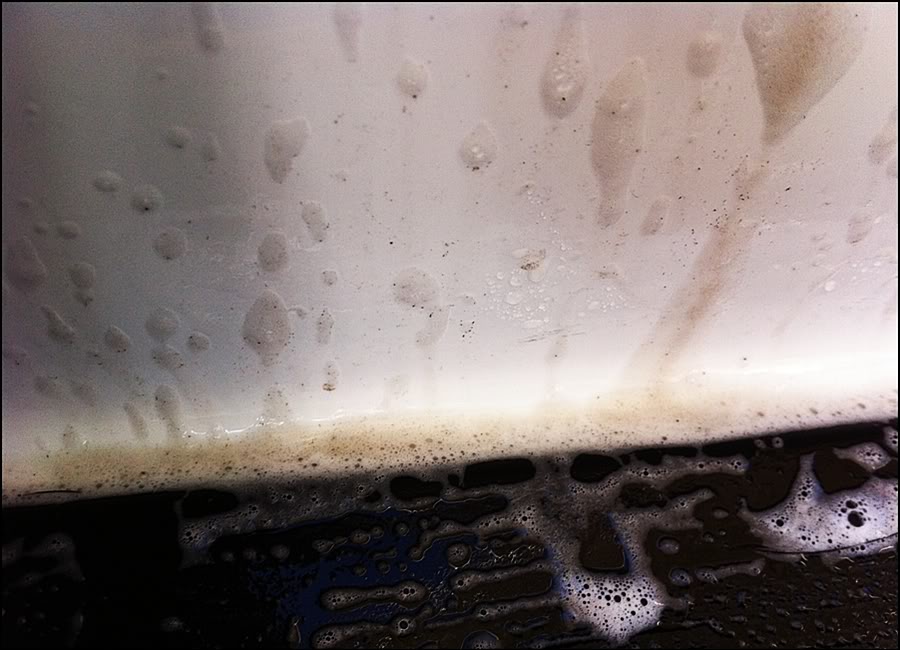

Quick Snowfoam and wash. Washed with my new favourite shampoo...

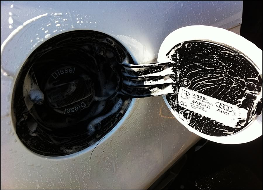

And the obligatory petrol cap shot ;)

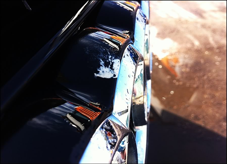

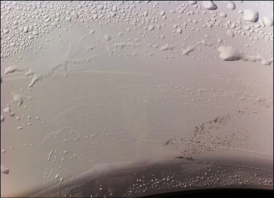

Onto the Tardis, White cars eh! 2 full hits, Tardis removed with a Blue MF applicator, works so so much better than an MF cloth imo.
Rear bumper corners were so bad...

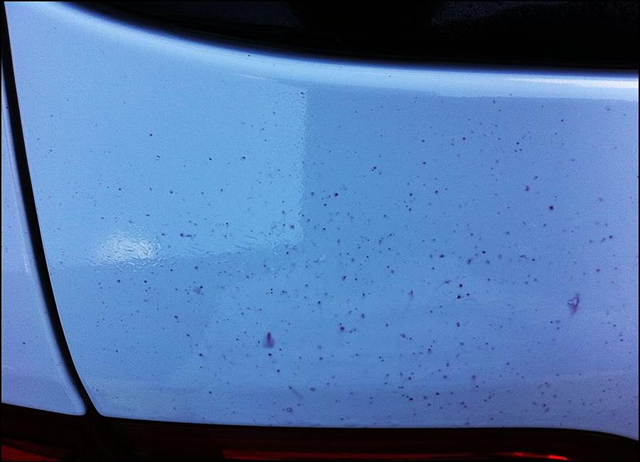

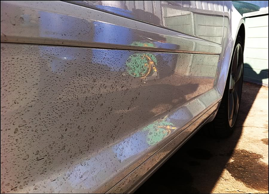

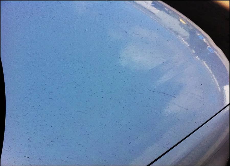

Then onto de-ironizer... another eye opener on a brand new White car, 2 hits required both left 30 minutes, time was way too tight...
Bonnet...
Rear...
Washed again after 2nd hit didn't seem to bring up too much more... need more iron remover now! :lol:

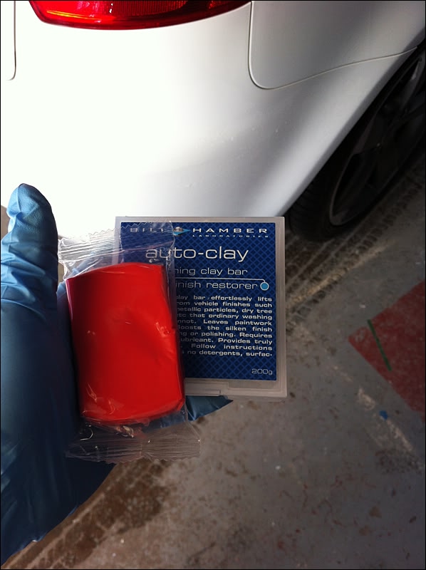

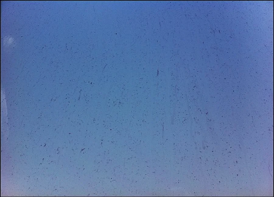

Rolled inside for claying, trying out some more Zaino clay, i'm in love with it and as always BH autoclay. Stalwart. Clay lube, water/demon shine mix...

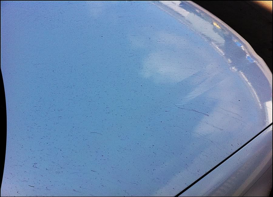

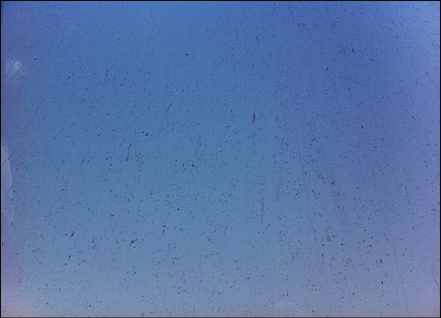

Another major point of my detailing since I learned the ins and outs of claying is the cleaner the clay bar the better. I cringe when I see people rubbing heavy tar over their paintwork. Anyway my two hits or tar remover and iron remover worked well...
Bonnet and o/s wing...
n/s wing and door...

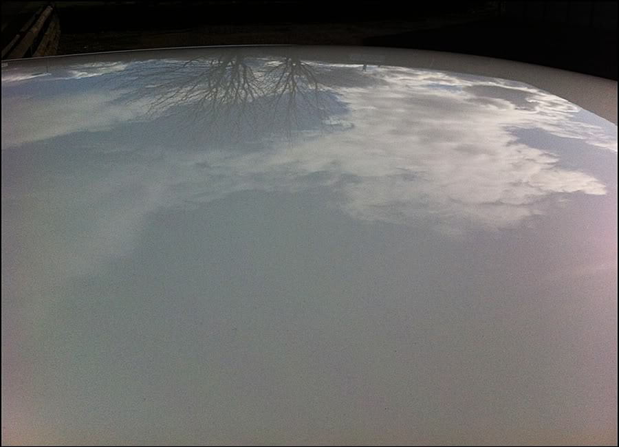

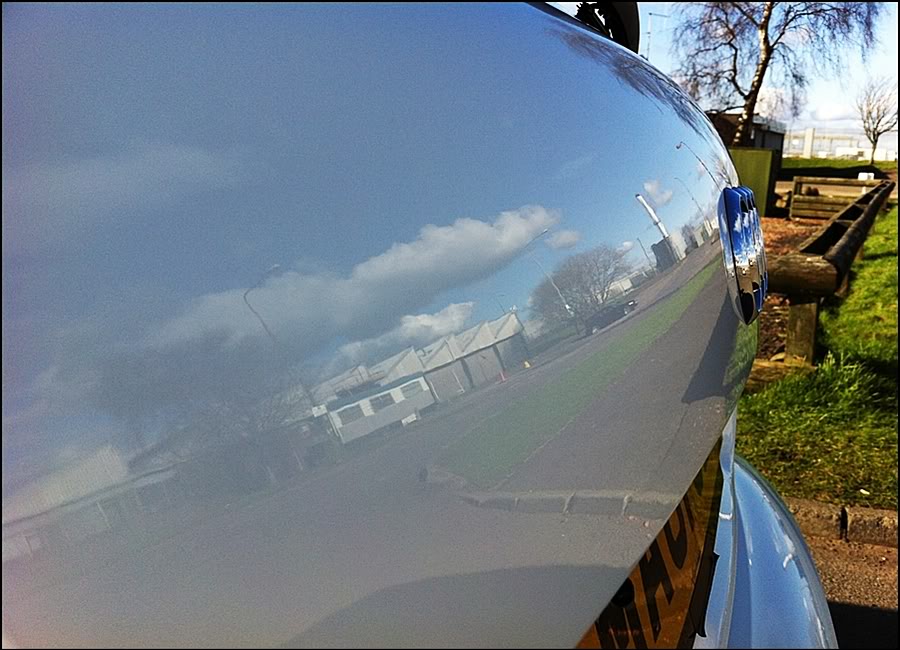

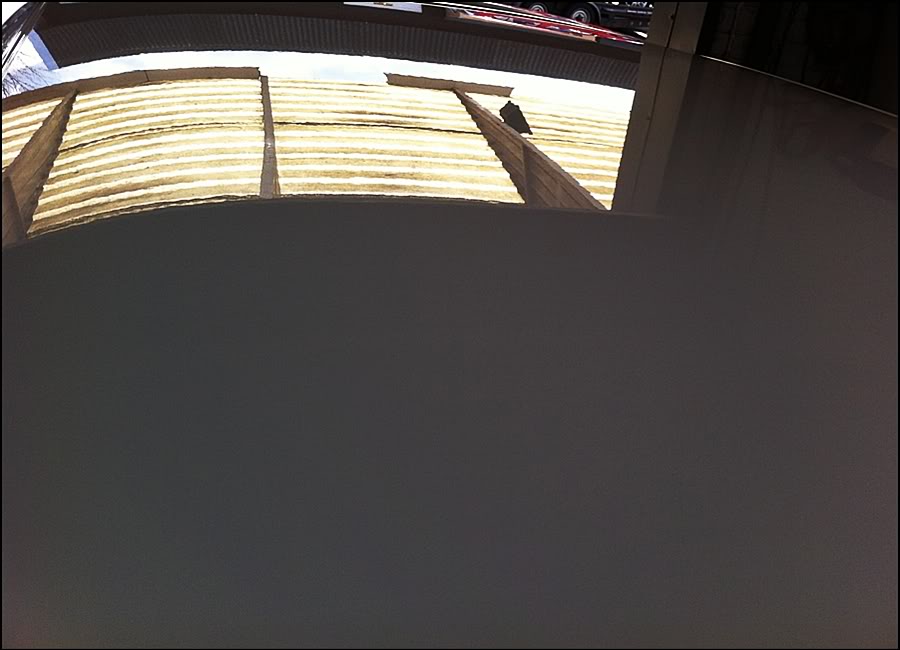

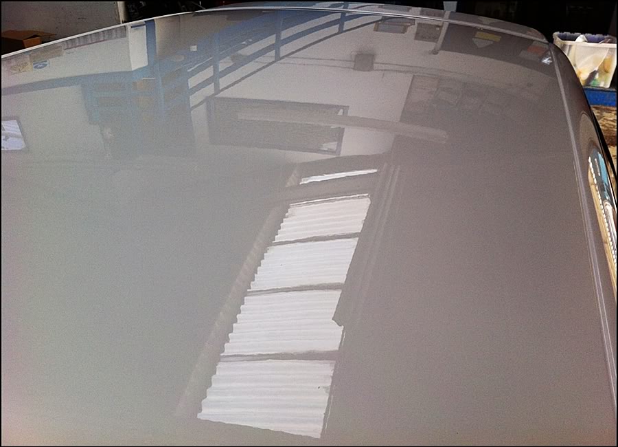

The Z18 had a bit more bite than the softer BH imo and had a bit more colour change after the roof, zero clay spots mostly just fallout.
Washed again and dried, back in doors for some polishing...

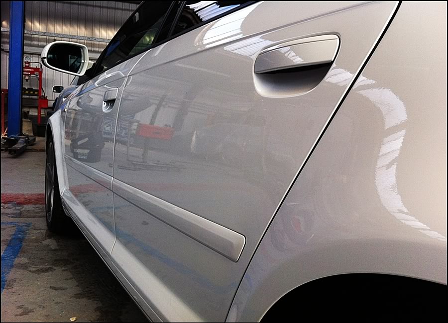

1 step polish just to nip out any small swirls from dealer prep, 106FA and a 3M yellow pad as always! ;)
Worked superbly well whilst leaving some marks that would have come out with more time spent, that wasn't the aim of the detail at this time.

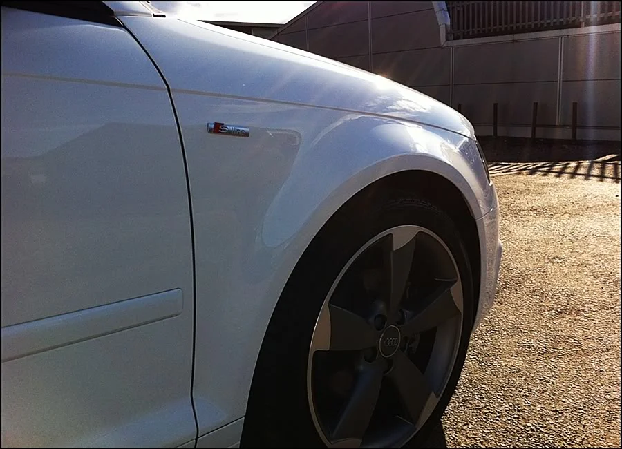

After polishing...

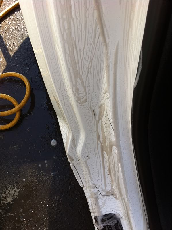

B Pillar trims were a little marked from the dealer, easily sorted...

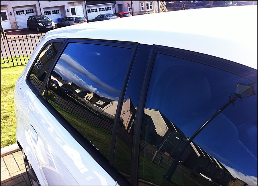

Few finishing touches, Glass with AF Crystal, front got another coat of G1, Trim with AF revive and tyres with Megs endurance as always

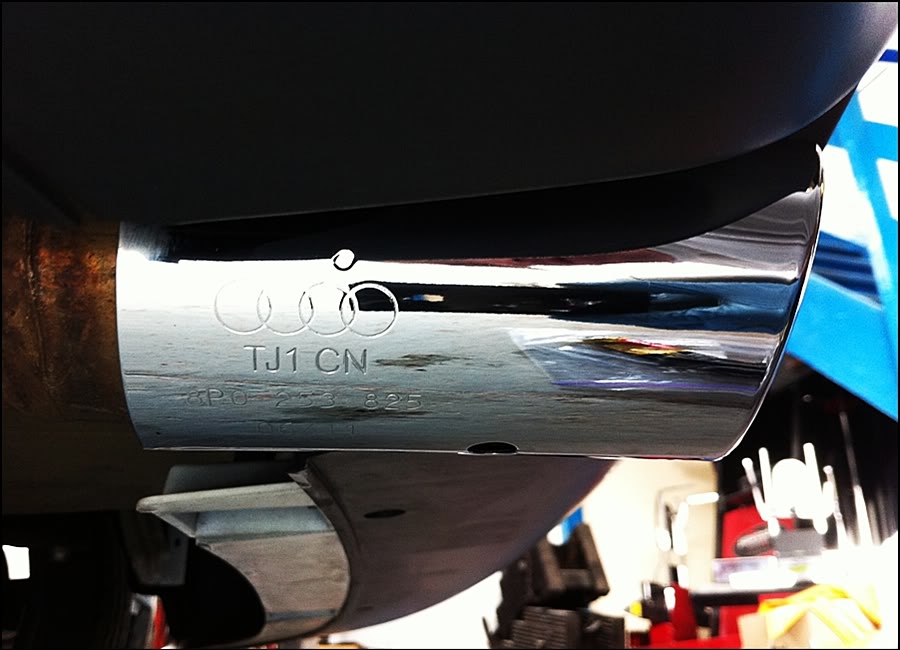

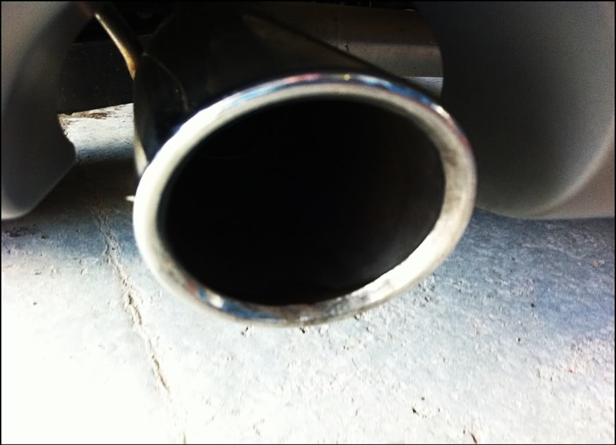

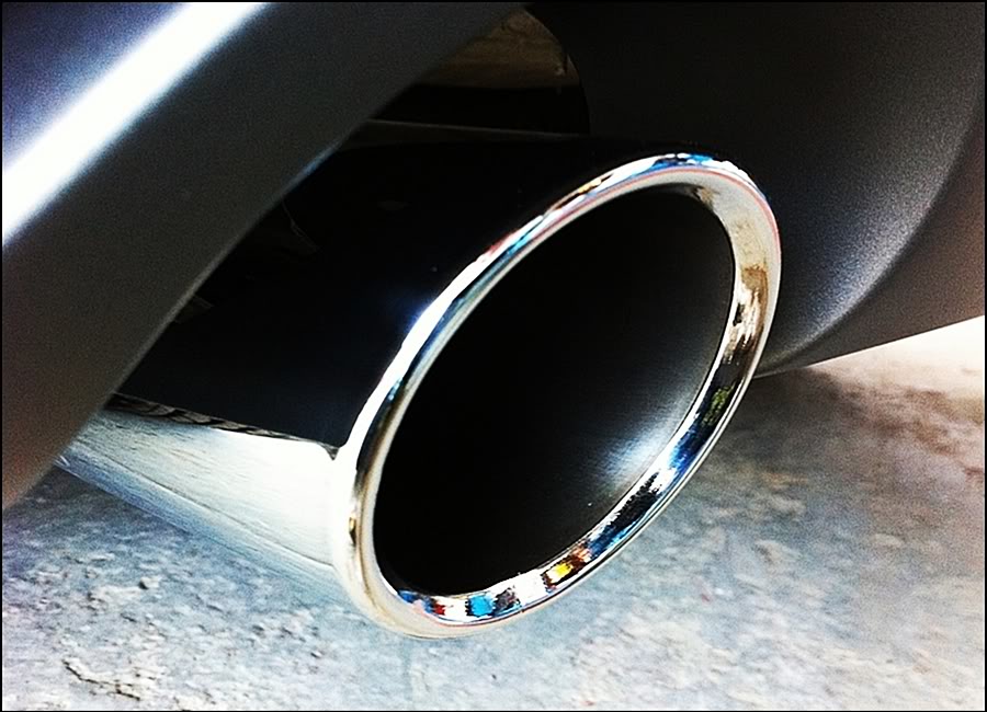

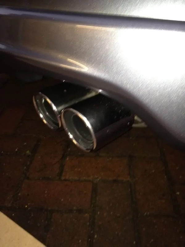

Exhaust treated with my favourite Autosol and super fine wire wool, IPA and C1 to seal...

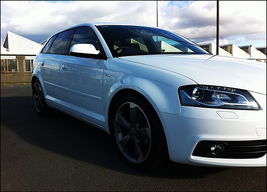

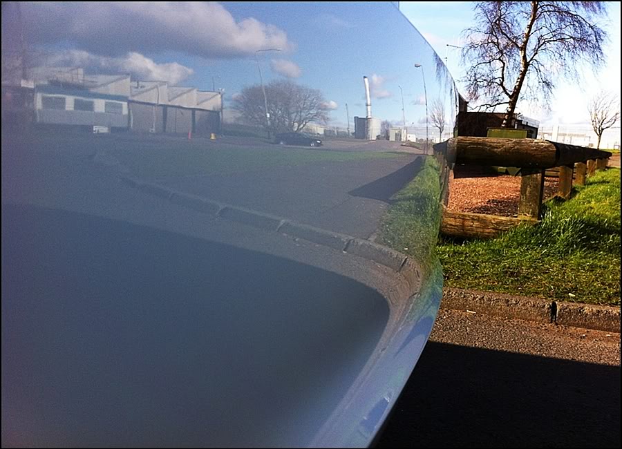

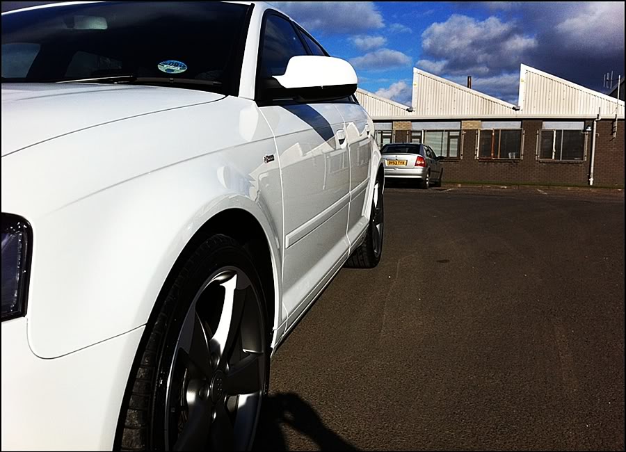

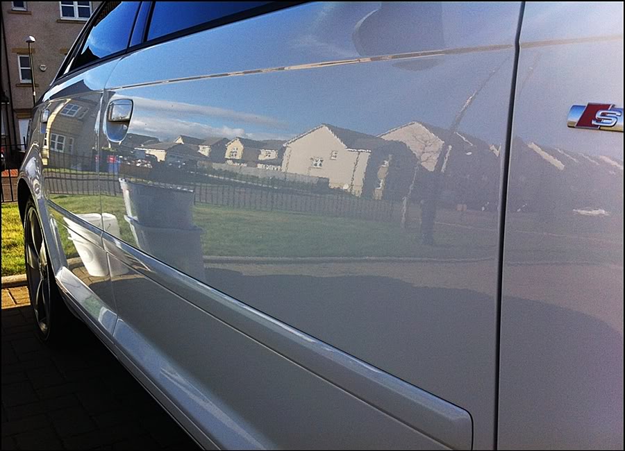

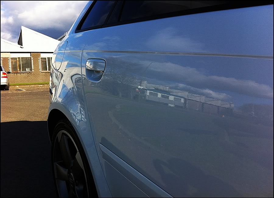

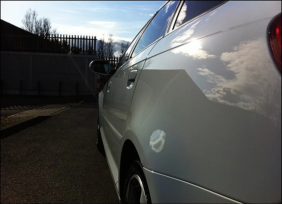

Enjoy the afters...

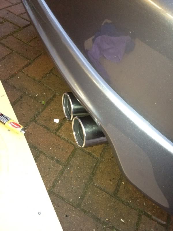

Thanks guys. The exhaust bar the tailpipe is in poor condition for a new car. I told them to speak to someone about it.

Did you seal the exhaust after Auto Sol BTW? or did I read that wrong?
Sealed with C1 mate. It's superb at making future cleaning easy.

How did you sort the swirls on the b-pillar?
I did it via machine but i'd buy something like AF tripple. It'll make a nice job of them with the fillers.

Yeah tough coat is fine mate. Spend lots of time with wire wool etc and then keep on top of it mate. Easier to clean that way. :)
Most normal sealants won't last but it will offer a lot of protection so will be easier to clean in the future. :)

We Autosolled my Exhaust back from the dead when I first got it
Just curious if I could seal it to make it easier to keep on top of, wasnt sure if Tough coat would melt :) Thanks

Well worth a try. You'll only use a pea size amount anyway.
