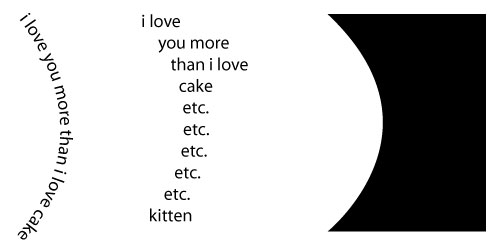

think i get what you're trying to say...
...you want to go from how it is on the left to how it is on the right??
if so, i made this by drawing the shape on the far right with the pen tool, then clicking near the edge of it with the type tool (your mouse pointer thing should change from a cursor thing in a square to a cursor thing in a circle) and then you can type away within that area :)
