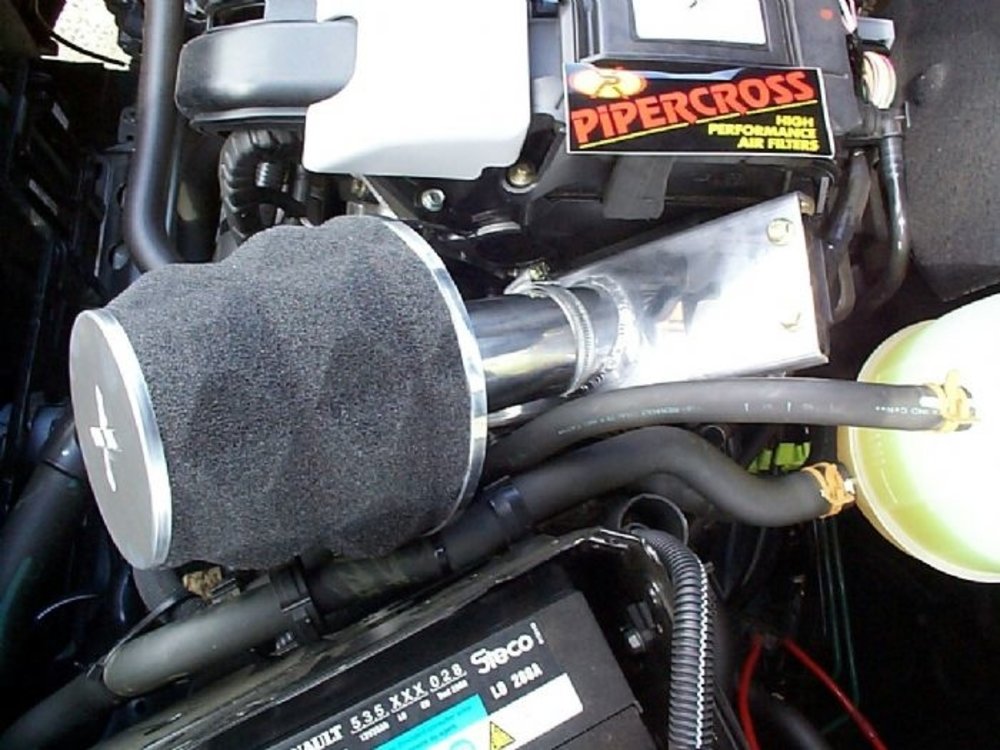

Once you get the airbox off you should be left with like a square opening. When you buy a kit for it you'll get like an adaptor plate that fits that opening which you then attach an air filter to.
Can't find pictures of my old one but it's something like this. Mine had a longer bit of curved tubing so the air filter was situated down near the radiator.
