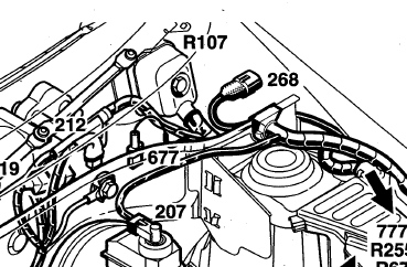

I'm a bit stumped as to where to go next. I've had the large white connector under the fuse box apart and cleaned up any dirty pins i could see with a file but that hasn't worked. Am i right in saying there's also another connector somewhere near the washer bottle that can cause problems?

The trip computer reset is indicative of a weak battery.
