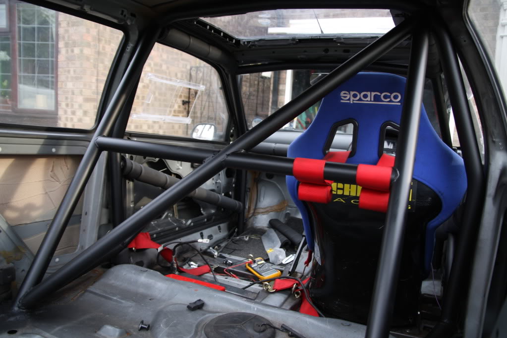

f**kin hell !! That is stripped. How the he'll did u loose 200kg ?
clio16valver said:
Im at 827kg (1/6th tank fuel when weighed) with a full cage that was around 35-40kg...what ive removed is:
* Lighter Engine (F4R)
* Removed Bonnet Skins
* Removed Boot Skin
* Removed Door Skins + Bars
* All Windows Polycarbonate
* Sunroof Frame Cut Down + 3mm Polycarb rather than glass
* Auxiliary Fuel Tank Removed
* No Heater Matrix or Blower Unit
* Lightweight Battery (5kg)
* No Dash (Apart from the Top)
* All Trim Removed
* All Sound Deadening + Carpets Removed
* Lightweight/Bucket Seats
* Cut Down 'Bare Minimum' Looms
Still got the tar to remove from the doors, but thats about it really. If it didnt have the cage it would be sub 800 with ease, but not very safe lol.
Got some more to remove yet, and got to collect some wheels that will save me 3kgs per corner, so another 12kg off the total there :)
