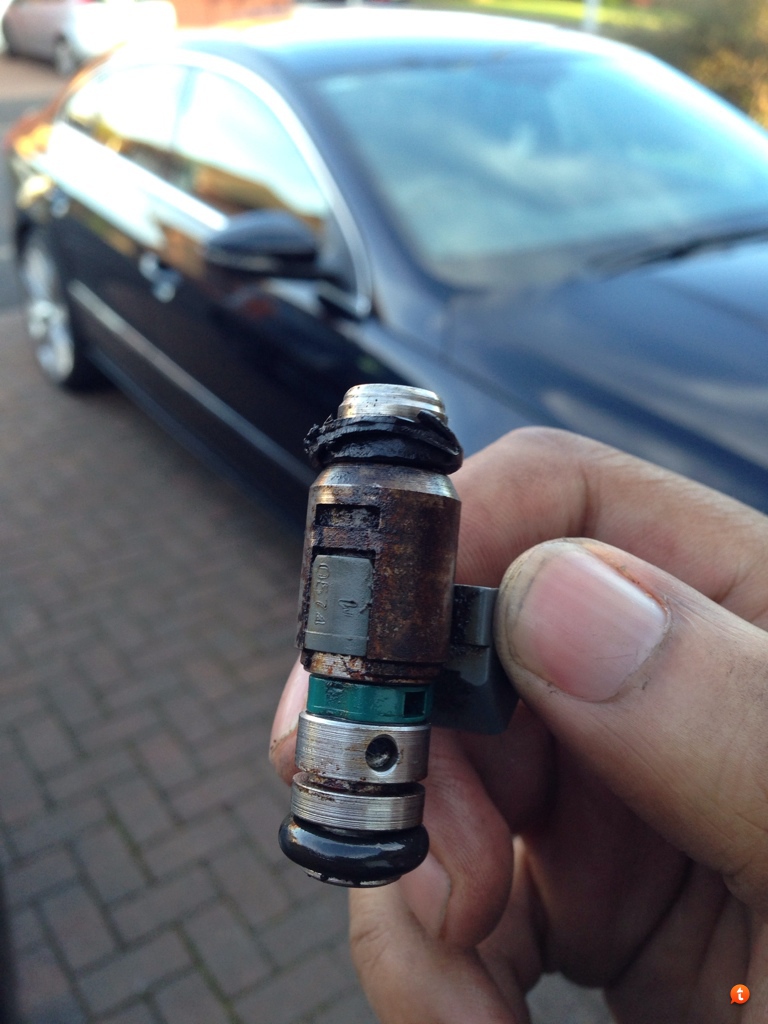

Check your injectors. Unplug the electrical connector one by one and the one that doesn't make a difference will be your culprit! (Obviously plug it back in before trying the next one)
Just awaiting an injector for mine.
Just swapped my injector over for the new one and the car is fine again! The old injector was a bit busted!

AA came to my house and diagnosed it as injector #4, picked a new one up. Got the rail off with a bit of wiggling and tugging. Pulled out injector (little splash of fuel) new injector pushed/clipped in. I'm now struggling to get the rail back in. Don't want to break something. Does it just need a bit of pressure?

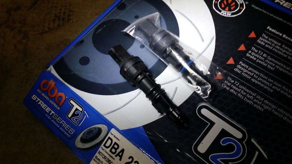

Not sure if it is the same issue but I had what sounds very similar.
Is yours a early PH2?
If so I would try the speedo sensor.
Does your speedo wave about sometimes ?
Mine did and I got a new aftermarket job from EBay and all cured now.
The ECU must get data from the sensor.
