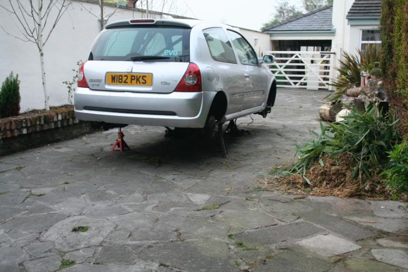

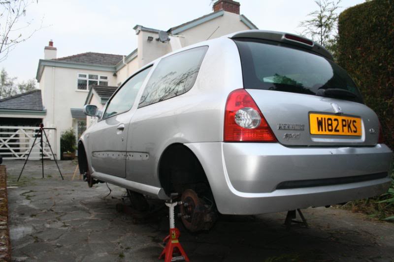

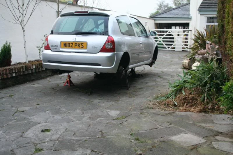

So have had the exhaust fitted for 2 months now and here are a few thoughts:
- the exhaust has definitely got louder since been fitted and also is much louder when the car has been running for 10 mins or so
- definitely seems to pull better
- mpg seems to have actually increased?
- makes a nice popping noise when you let off the throttle
...only negative is that the system keeps hanging low which i believe may be because my mounts are knackered...other than that a great system which I would thoroughly reccomend :)

This is with the system jacked up so it's actually touching the car (ie as high as it can possibly go)
  Black Ph2 172
I have seen some on here that are completely Stealth I think? Mine was when first fitted but I think as exhaust has expanded it now hangs a bit lower?

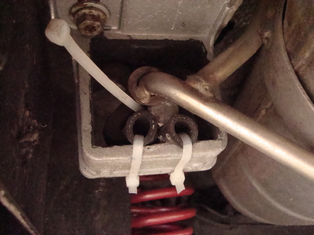

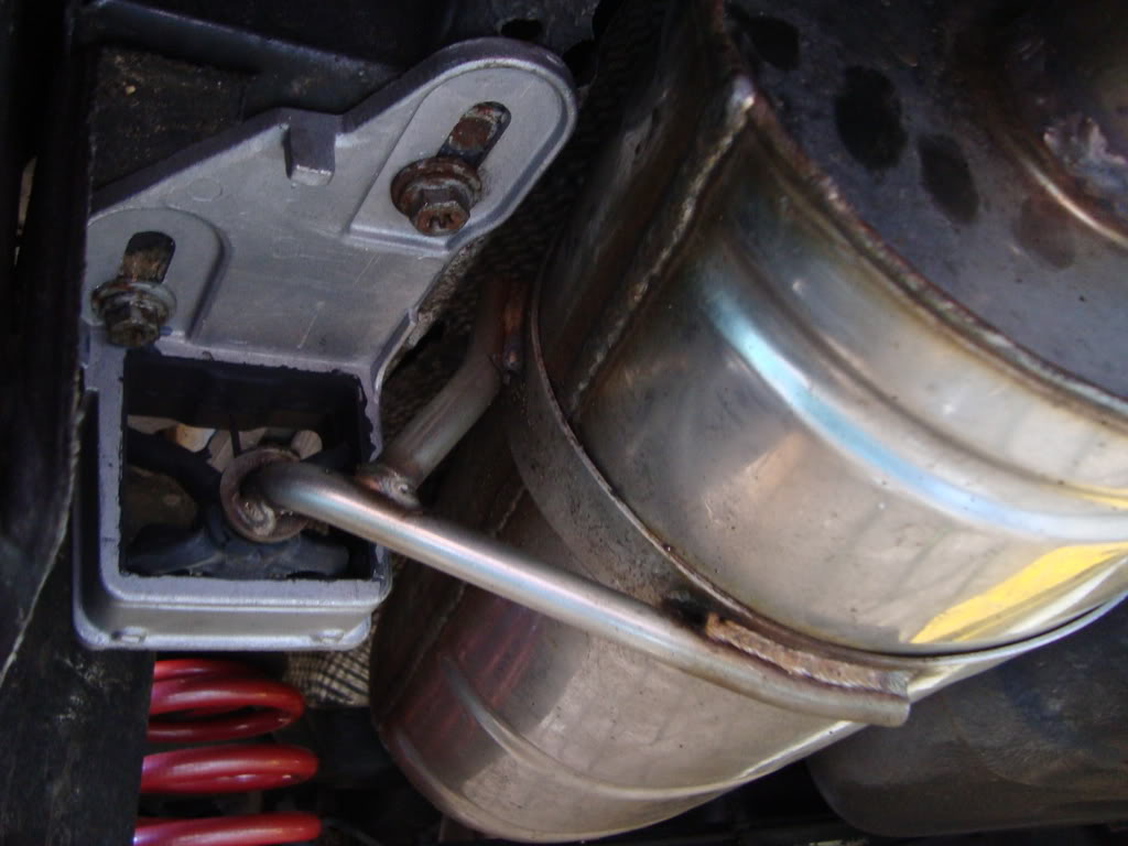

this is how mine looked with the new mount...
but obvioulsy didnt fit right. so i bashed the exhaust clamp with the mallet until it looked like it lined up. I havnt seen the reinforcing guide but i packed mine with rubber hose and then a bolt inside the rubber hose in the middle. Its not very pretty but you dont see it so not that fussed.

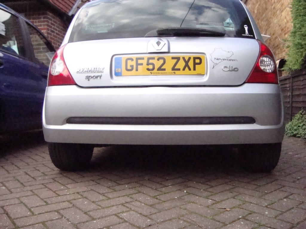

and this is how it sits.
