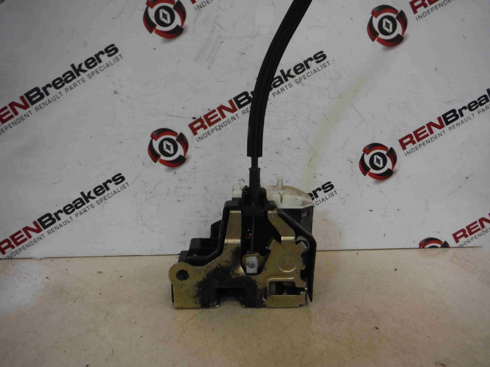

In the pic I've attached of a mark 2 front door mech that's on ebay, the cable looks as if it's contained within a sheath. This make me more concerned about the likely effect of pulling on it than if was a naked cable. Fingers firmly crossed!
You could be right there, door wedge and long pointy thing it is then.

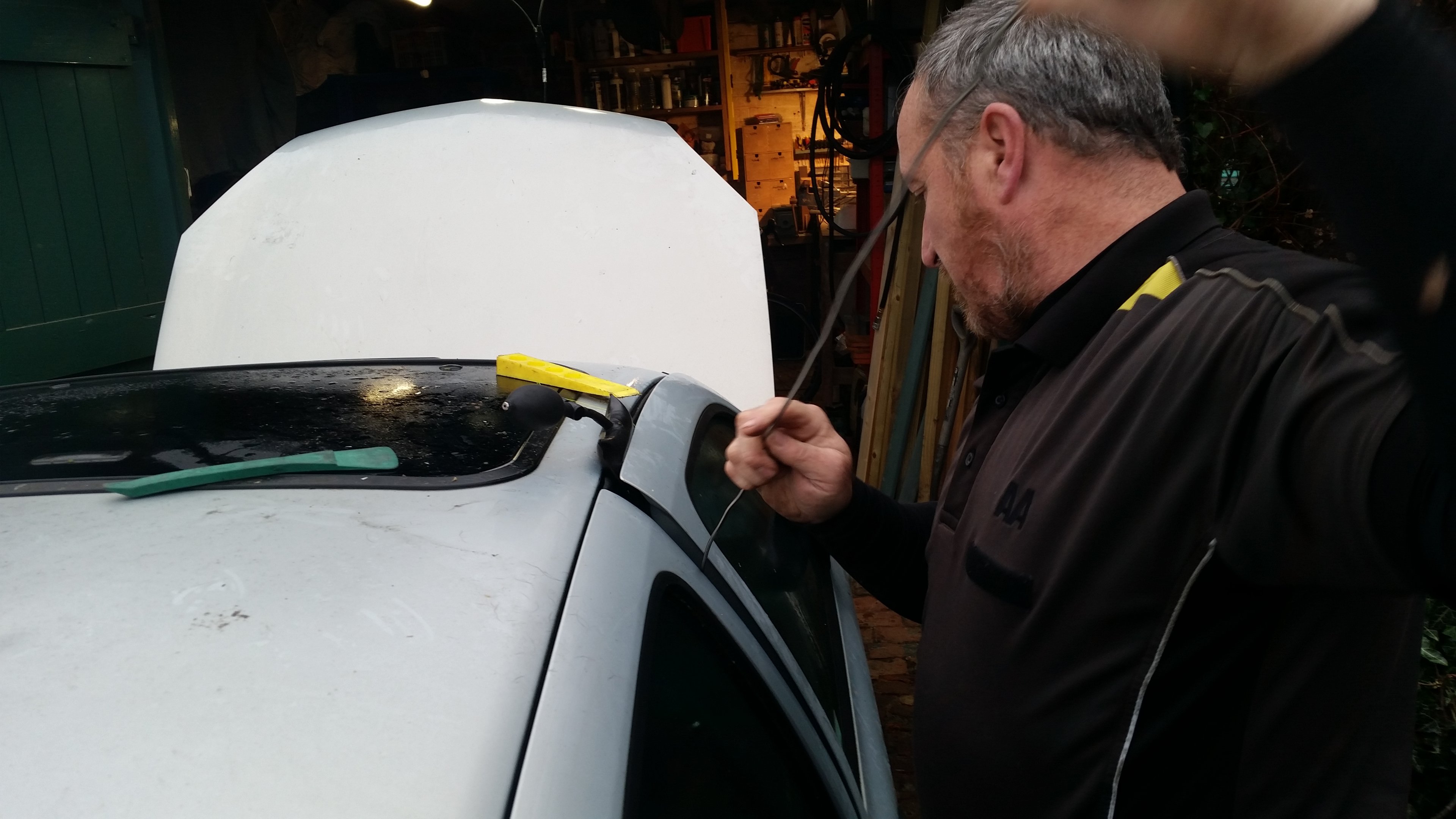

Ok all, the result is......
AA man in 3 mins. Pic attached. Hero. I couldn't get the top of the door nearly open enough. A coat hangar by the way doesnt reach the dash button until there's hardly any to hold onto. It has to be done from the rear of the door to have any hope of any forward pressure on the button. The AA man had some plastic wedges and critically an inflatable cushion. He then used some fairly stiff wire, looked like fencing wire. Anyway all sorted much as predicted and thanks very much for all your advice.
