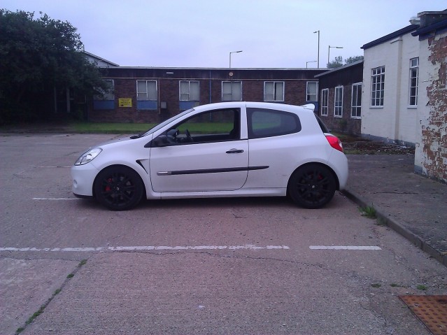

Hi! I just purchased a set of v1s for my 2009 197 cup. I have gone to fit these and have come accross a few
problems such as the rear shocker does not pass through the rubber bush on the rear top mount. (piston to big for hole) front top mount bearing was to big to fit the shock. Also the shock wa very tight going into the front hub.
I have called demon tweaks and they have tol me that kw don't make a kit for the 197 cup and I have to return it. I'm sure they are wrong as I have seen v1s fitted to cups. Anyone else had issues like this as they are just going to refund me and I'd prefere just to get some coils fitted.
Thanks Kyle
