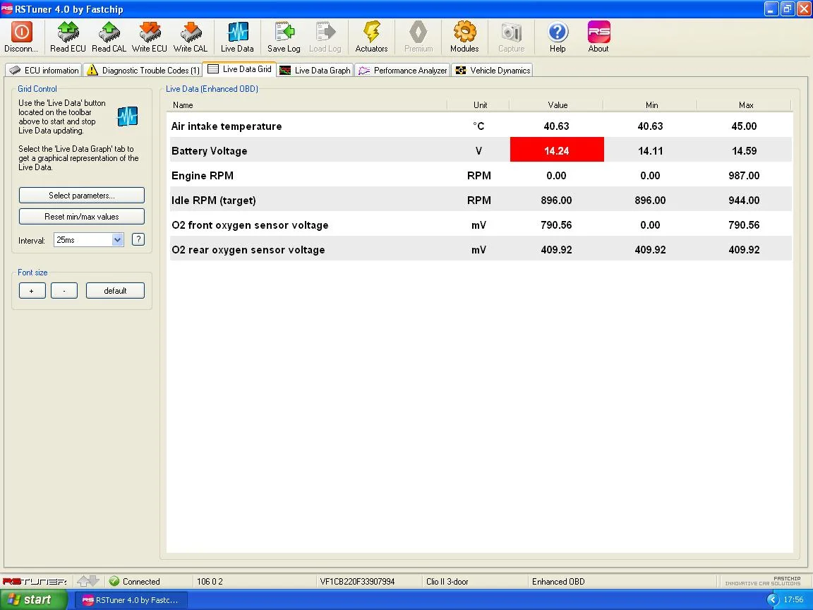

Am sure it is but just checking. Did a RSTuner cal the other day and the engine management light came on after. Had a look at the fault codes and there were none.
Asked fast chip if they had any idea what it may be but no joy.
Looking again today and there is a 02 sensor fault in the memory. Had a look at the live data and got this after 5 min of tick over.
Rear voltage sensor never changed from 409.92
Do i take it the after CAT lambda sensor is FUBAR?
Thanks for any help

mine does exactly the same and its exactly the same reading,i also have the 'rear 02 sensor' fault, think its just a new sensor needed there pretty expensive though best price so far is GSF

Hi the rear almbda sensor voltage correct if continual the voltage(0,409Volt) because it's check the CAT correctly working. :)

yeah, rear lambda should read something like that, and front lambda should be jumping like crazy exactly like it does, always under 1.0
