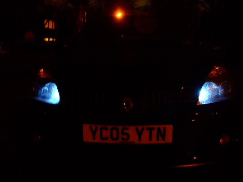

These are the ones fitted in mine . They match the xenons perfectly .
http://www.ultraleds.co.uk/u501fw-white-ultra-bright-frosted-bulb-brighter-p-866.html

LED side lights only look good with xenon lights, other wise they will look too bright compared with the main beam.

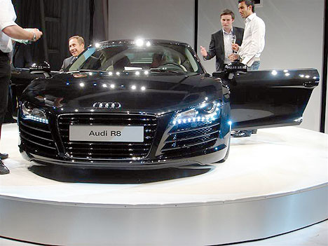

answer me this then if leds are illegal why has the audi r8 and a few others got led sidelights? makes no sense to me

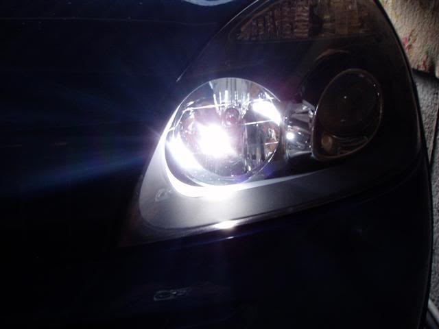

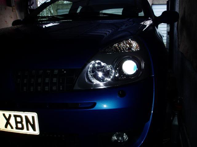

they look so much better than the original sidelights. Is it exactly those in that link?
Yep , same as in the link . £2.00 each . They can be a bit of bugger to fit on the offside due to the aircon . I've sussed it though . Get yourself a piece of 10mm plastic tubing , put the led in the tube , then hold the the bulb holder with your left hand and push the led into the holder using the tubing. Job done , only takes a couple of seconds then ;)
