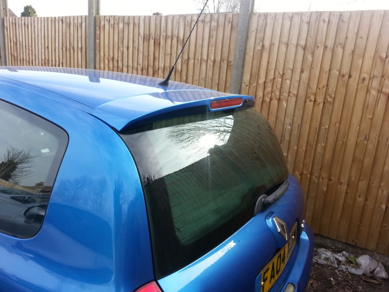

182, is that a Cup spoiler? THINK it's got Cup suspension pack on it, no splitter though.

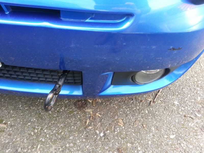

Front end respray?
Bumper I think.

PS, Full fat 182, both cup packs.

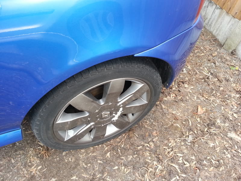

Tyres all have very good tread (Michellins) but rears cracking round tread blocks.

It's one of those things, it is screaming at me to buy it but I need to seriously think and have a good look. Looked in good condition other than the blemishes and s**t job on the front bumper but I can respray that myself or prep it at least and get my old work place to spray it for me.

Anyone else notice the fog lights are installed the wrong way round?
