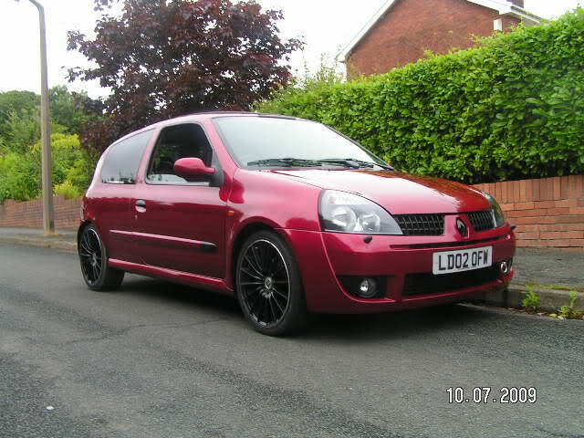

Alrite sorry for gash quality in the pics, i was just about to rain do just took it quickly:
