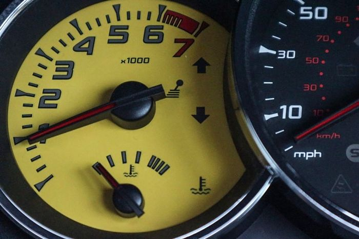

Even though I have a new thermostat the gauge will sit on the third mark on the picture below.

Third including the one its sat on? Can you get a picture of it when warm although does need plugging in really for accurate reading.
Rojer
If you imagine the gauge reading bang in the middle it's the mark to the left of it.
Needs confirmation, but in my experience that is reading too low. Does rev limiter seem to cut in early?

Nah goes to the redline fine, the old one was definitely shot as the pin had punctured the thermostat. I could change the CTS to be safe, but I think alot of people have the gauge in the same place. Previously I noticed the gauge would go back down where as now it stays solid and car warms up quite quickly.
JamesBryan
Yeah 3rd line/mark is correct as that's half way between the 1st and the 5th.
Most think it's half way between either end points.
