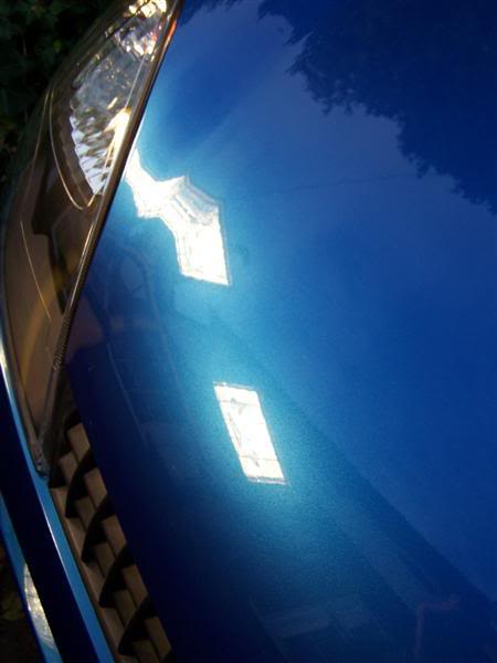

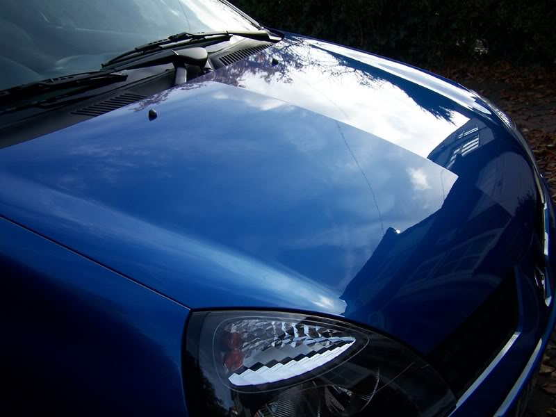

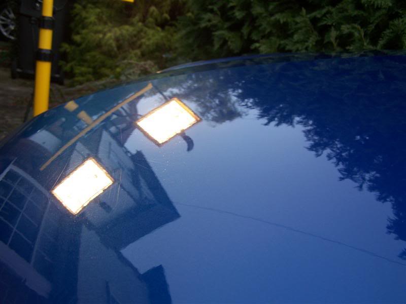

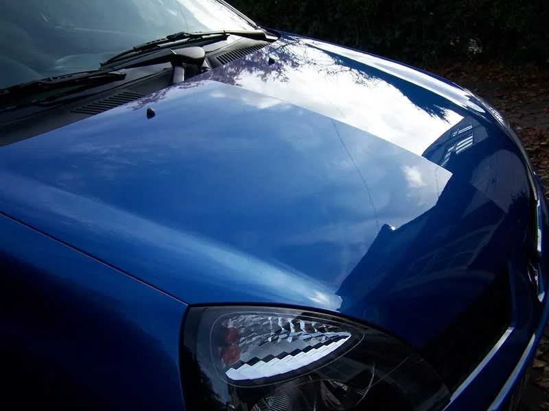

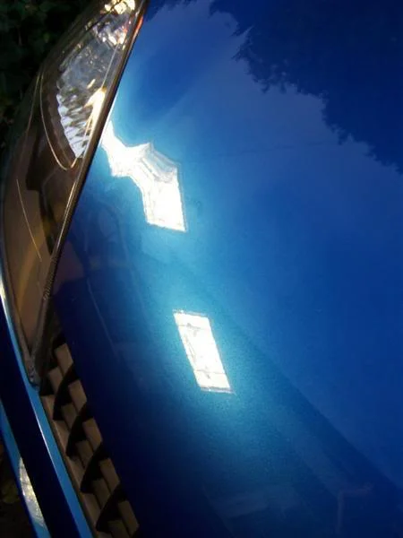

My first attempt with a PC and Menzerna IP 3.01 and FF:
Before shot:
After:
  172 Cup
I used the following:
Sonus SFX-1 Spot Pad with the IP
Sonus SFX-2 Spot Pad with the FF
I was alittle undecided which pad to use with the FF but it seemed to turn out ok. It took about 5-6 passes with the IP to get 99% of the marks out.
