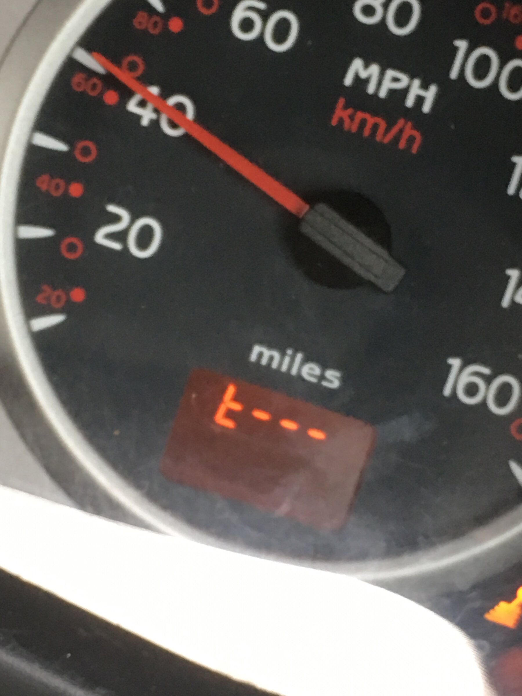

If you do the little trick of pressing the end of the stalk while turning the key to position 1 you should see a "t _ _ _' if its an injector stored code. You reset it by pressing the odometer reset button.

When you do that little diagnostic trick you have to keep pressing the button on the end of the stalk until you come to _ _ _ _ or maybe t _ _ _
This code?
Removed the code but now car wont start
  clio f7r valver
Yeah that was the code for a stored injector fault.

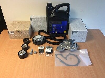

I'm getting my cambelt service done tomorrow at Birchdown, the full genuine kit with water pump, dephaser, cam seals and coolant is £265 on eBay from Renault , Swindon.
