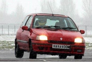

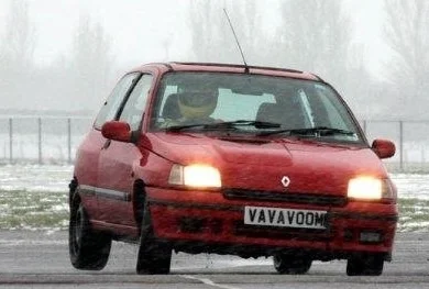

I co wrote a buyers guide many moons ago for 'French Performance Car', my old red car was used for the write up, Terryc101 now owns it..... God, I miss that car.
