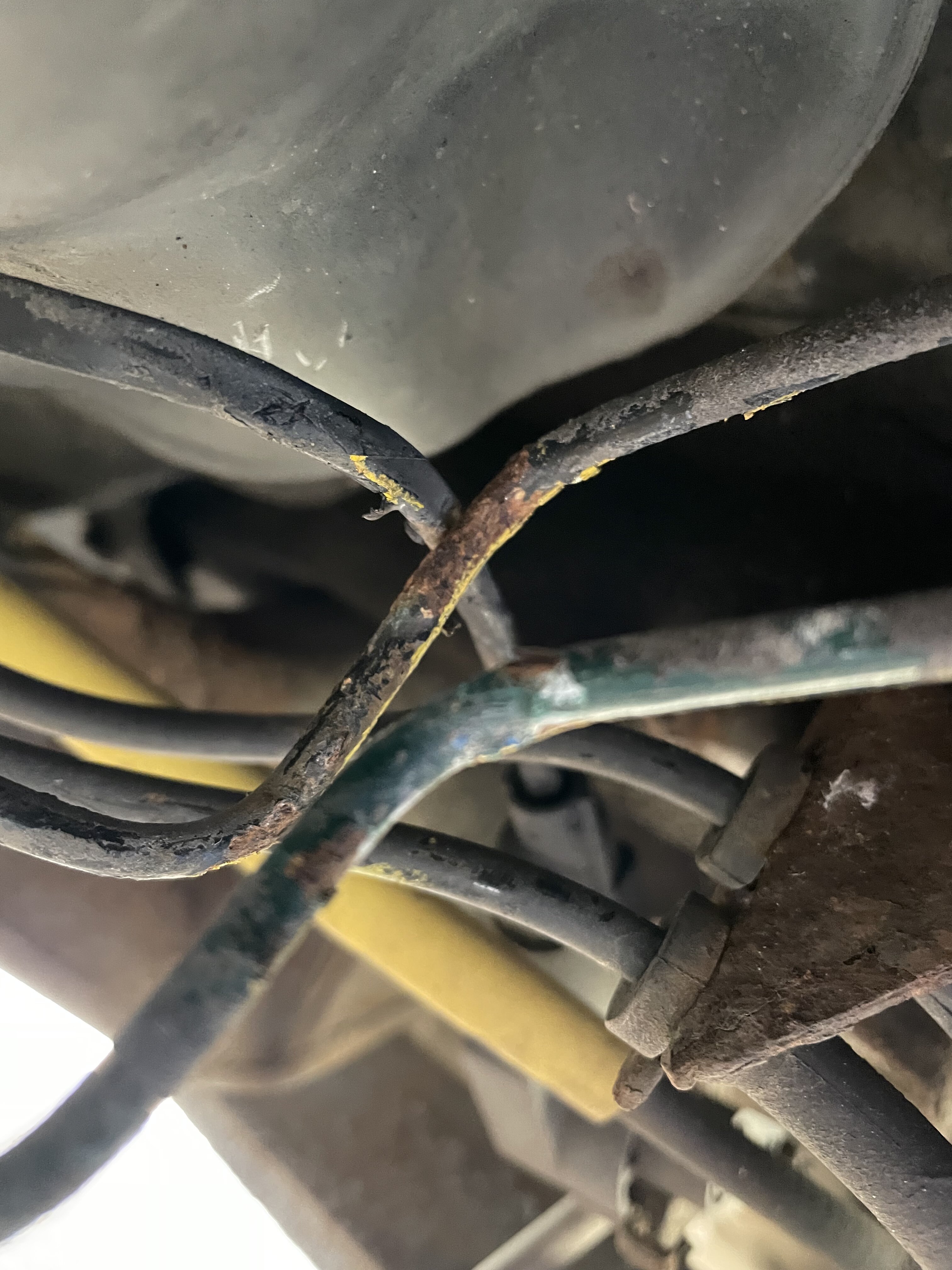

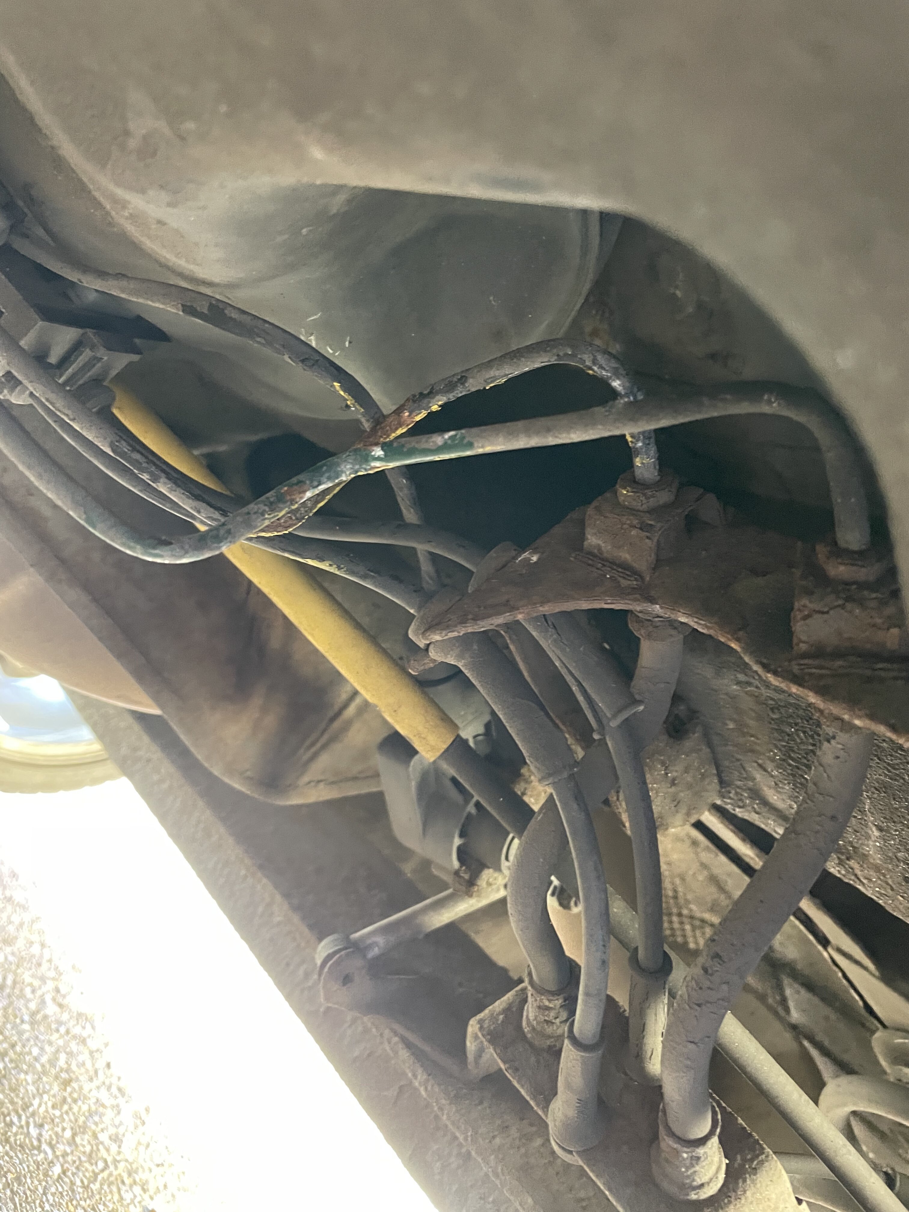

Hi everyone, I’m after some advice on my 2003 172.
The car failed it’s MOT for corroded brake lines. I have seen braided kits for the car but I’m unsure if the affected pipes are available/in the kits.
Does anyone know if these are available as a kit, new from Renault or if they have to be made?
Any help/advice greatly appreciated

As above make a new set easy for that line, any good garage will probably do it for an hours labour. They join at the join you can see in the pics obviously and the other end is under the car just before it goes up the chassis leg towards the engine bay
