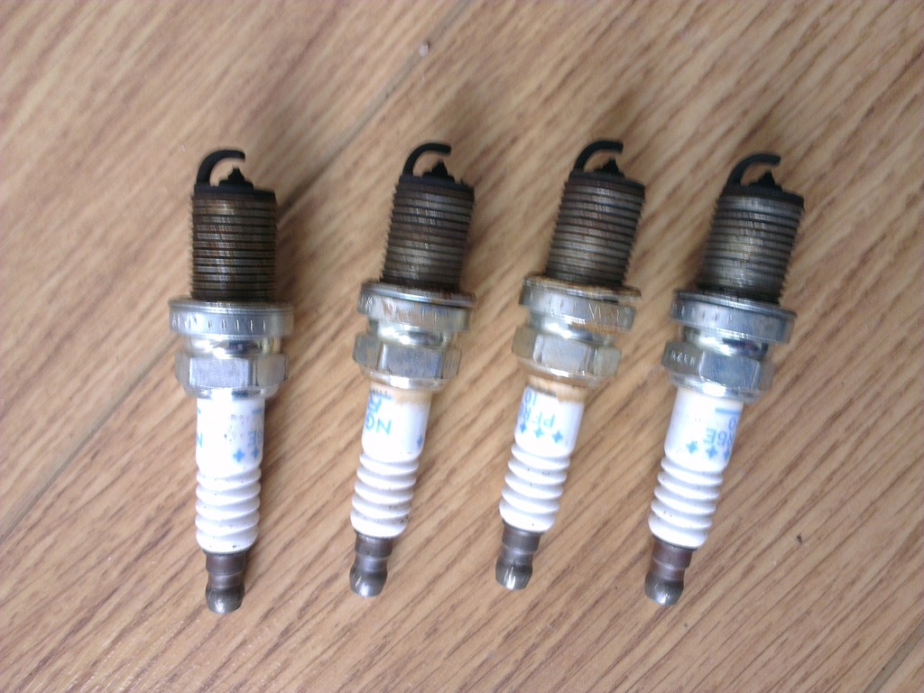

I've pulled all the plugs out and they look considerably cooked considering they are only a year old, does this look right? I've also swapped over the map sensor with one I've had spare, tired unplugging injectors one at a time and all of them make a notable change so it's not as if one stands out over the others.

Going to have to wait for the Reader then dude. Not sure about the state of the plugs, sure someone will be able to comment for you though.
