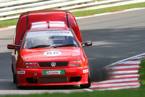

My Off at Oulton Park
Lucky you got it stopped before the tyres. What car?
Not a car but a Van :race:
and I think a owe all the stopping down to the gravel trap they do work after all :eek:
Cool! Ex VW Cup?
Specs?
Yes EX VW Cup here the sales add from the guy I bought it from had to use the turbo already :mad: no way is it running 220 and the guy said 210 when we picked it up

And a diesel :S did you lock up? Light rear end?
I know the front pads was getting low and was checking them after each session but forget after the last one so when I hit the brakes only the one front worked and locked so off we went at around a ton I thought it was game over and it nealy was but still 4mm on the over side pads :eek: won't be doing it again new Pads from now on if they are getting low they was 4mm on the pads before the start of the day and they only did 30 mins if that :eek:
