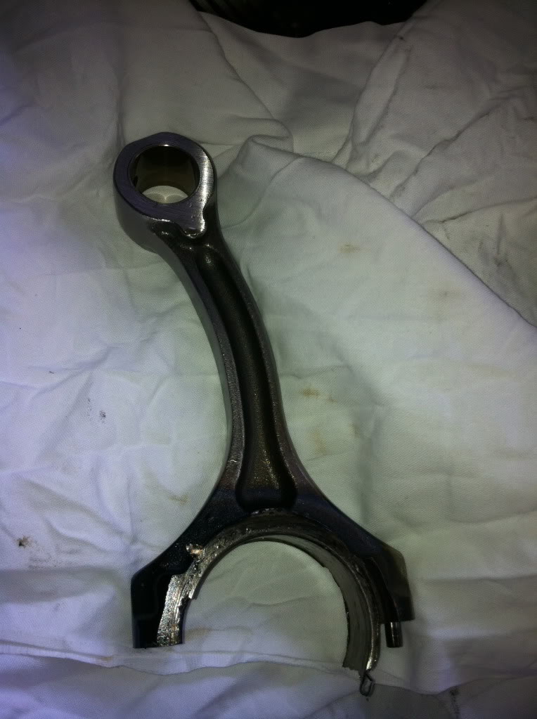

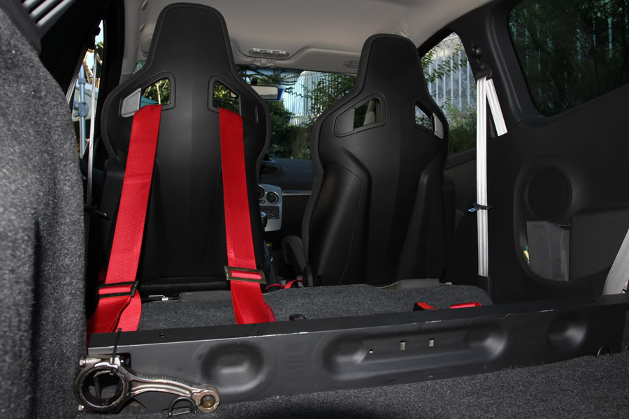

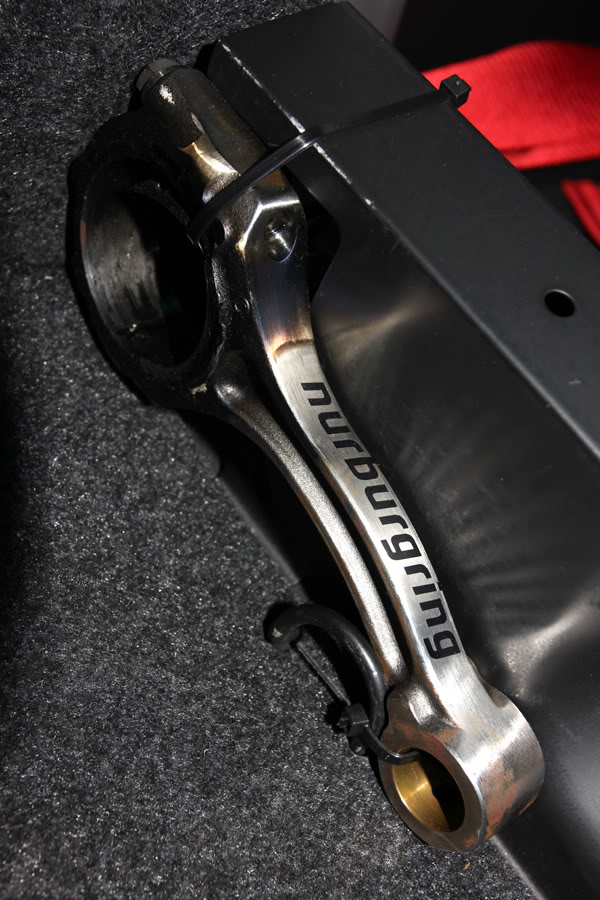

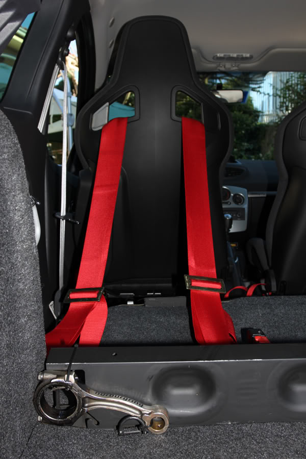

That is perfect, whats with the bent rod in the back?

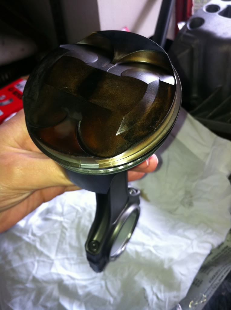

Last April i went to the ring and on the Kesselchen i had this "little" problem.....

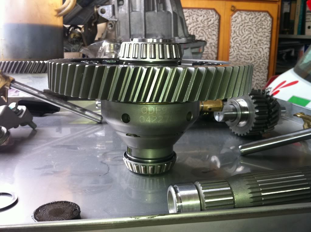

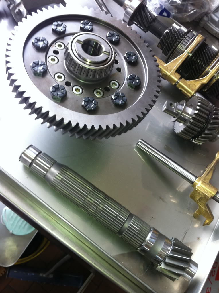

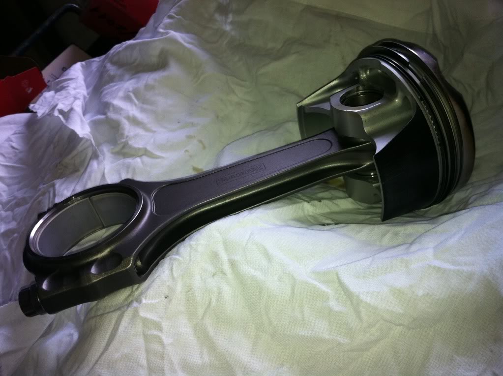

So i changed the connected rods and the crankshaft..with these forced works i also fitted the quaife diff. and i change the standard couple (16x69) with the new and a little short 14x69..

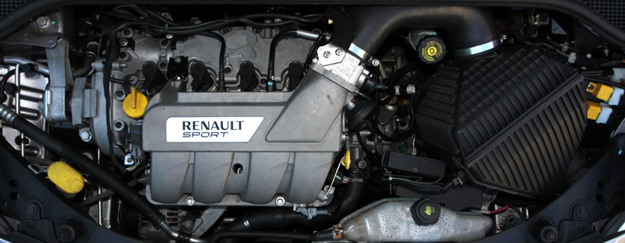

Now i a very similar r3 engine..
250 piston from december
250 crankshaft
230 camshaft from december

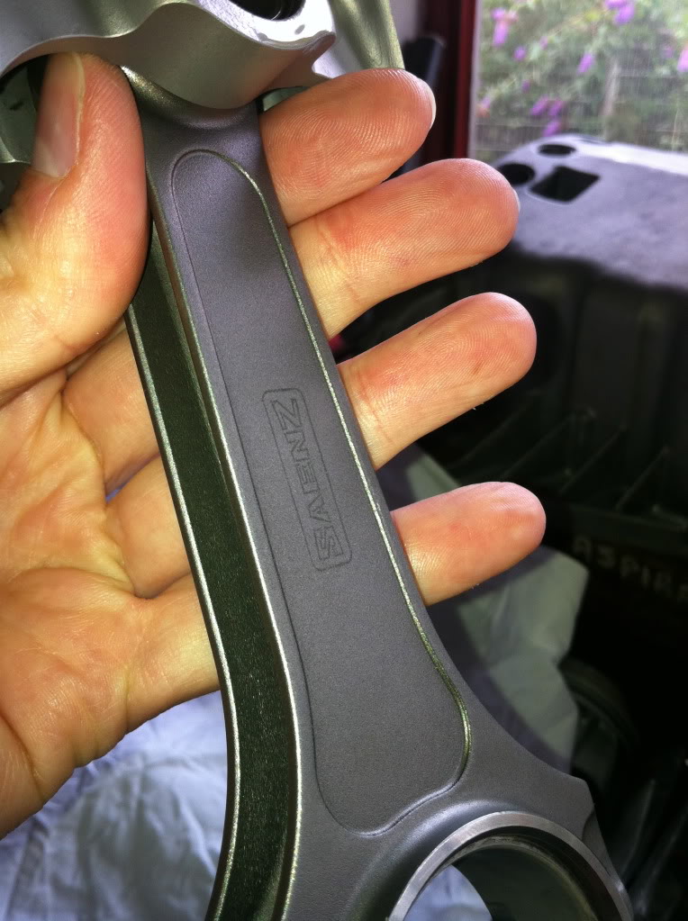

Saenz connected rods
Cable throttle body from december
Parallel ecu from december
Engine room mapped from december
  rs r27
I don't know in you country but in italy there was many same/similar problem!! And all on stock engine, all problem are from connected rods bearings or from the crankshaft..
Mine is more serious because i was on the kesselchen @170kmh and before i understand i make i think 500meters.. (i stopped on the right before the karussell)
The others my friends had this problem on city/mountain streets and they stop after few meters..

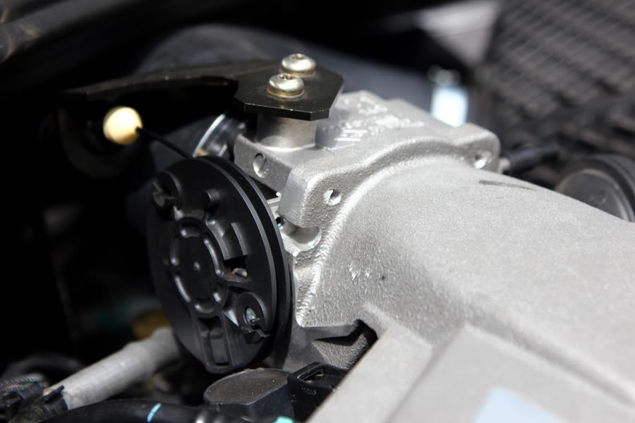

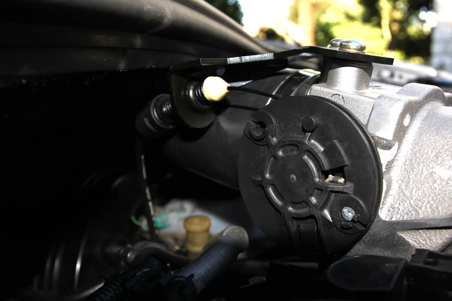

What's with the cable throttle body mod? Is it for driveability or will future mods not work with the drive-by-wire?
I forgot to reply to a part of your answer..
Is more simple and "sure" make a remap with cable throttle.. Usually many racing ecu (like motec, magneti marelli, but also my get data (ex tdd)) don't have drive by wire setup included. If you want it you need to buy (around 300/400€).
So we decided to put the cable, is many many better than dbw..
