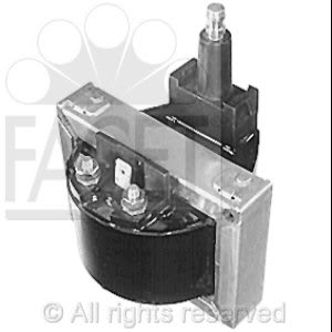

ever since buying the car its never been a good starter, its worse in winter but even in summer it has to turn over a time or 2 to get it going...
after being told by loads of people that it wouldnt be that, and spending money on other things, it seems it was the ignition coil causing me so much grief
got a new 'Facet' one today and the last 4 starts have been brilliant, turns over fast and just fires up like a normal car
i realise now ive said this that in the morning its gonna go back to its old self, but im hoping it wont lol
now, every part of my ignition system is less than a year old, plugs, leads, dizzi cap, rotor arm, distributor itself!......and now the coil
f**k YEA !!!
I worship thee, oh new Facet coil of wonder !
