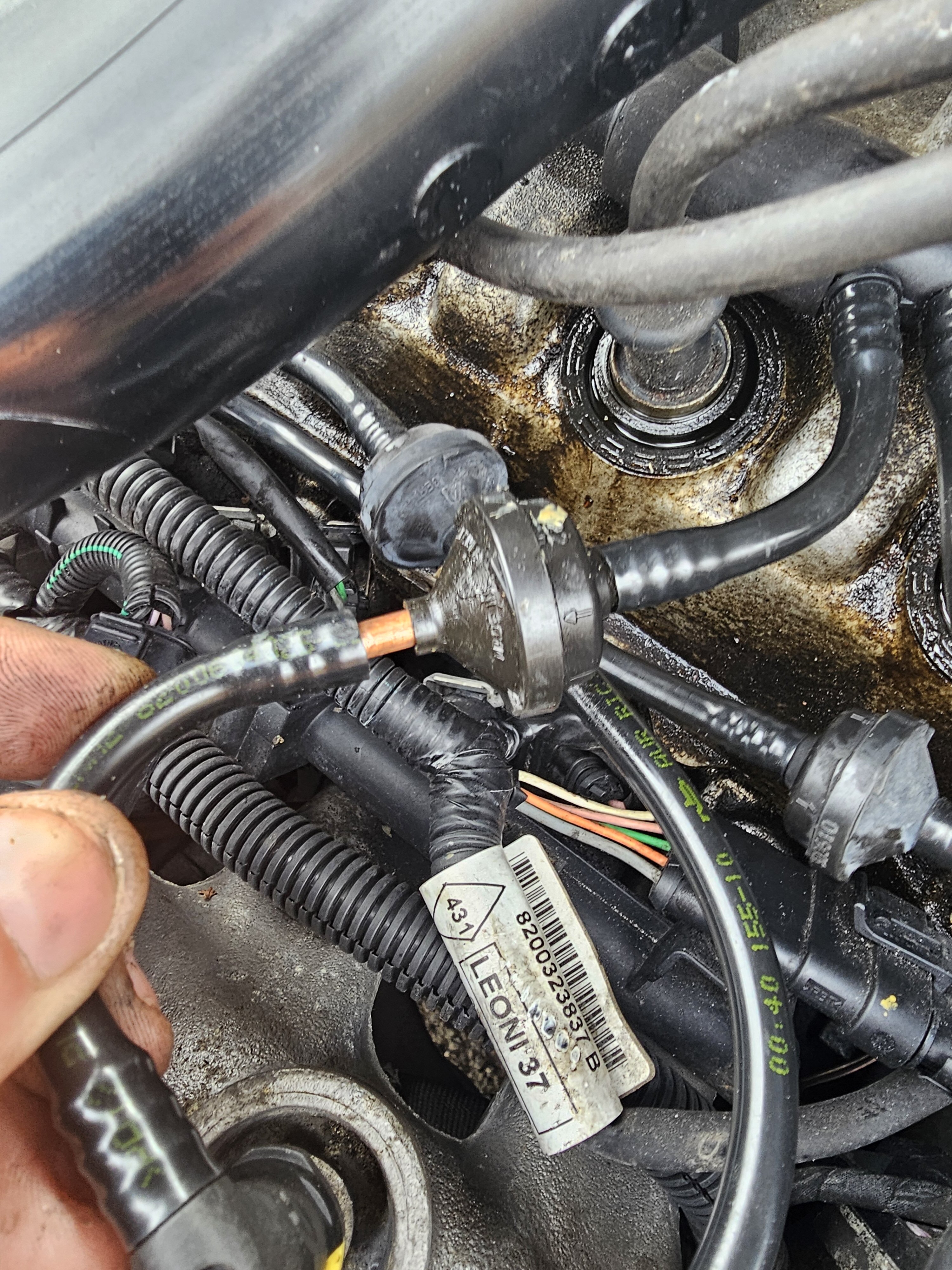

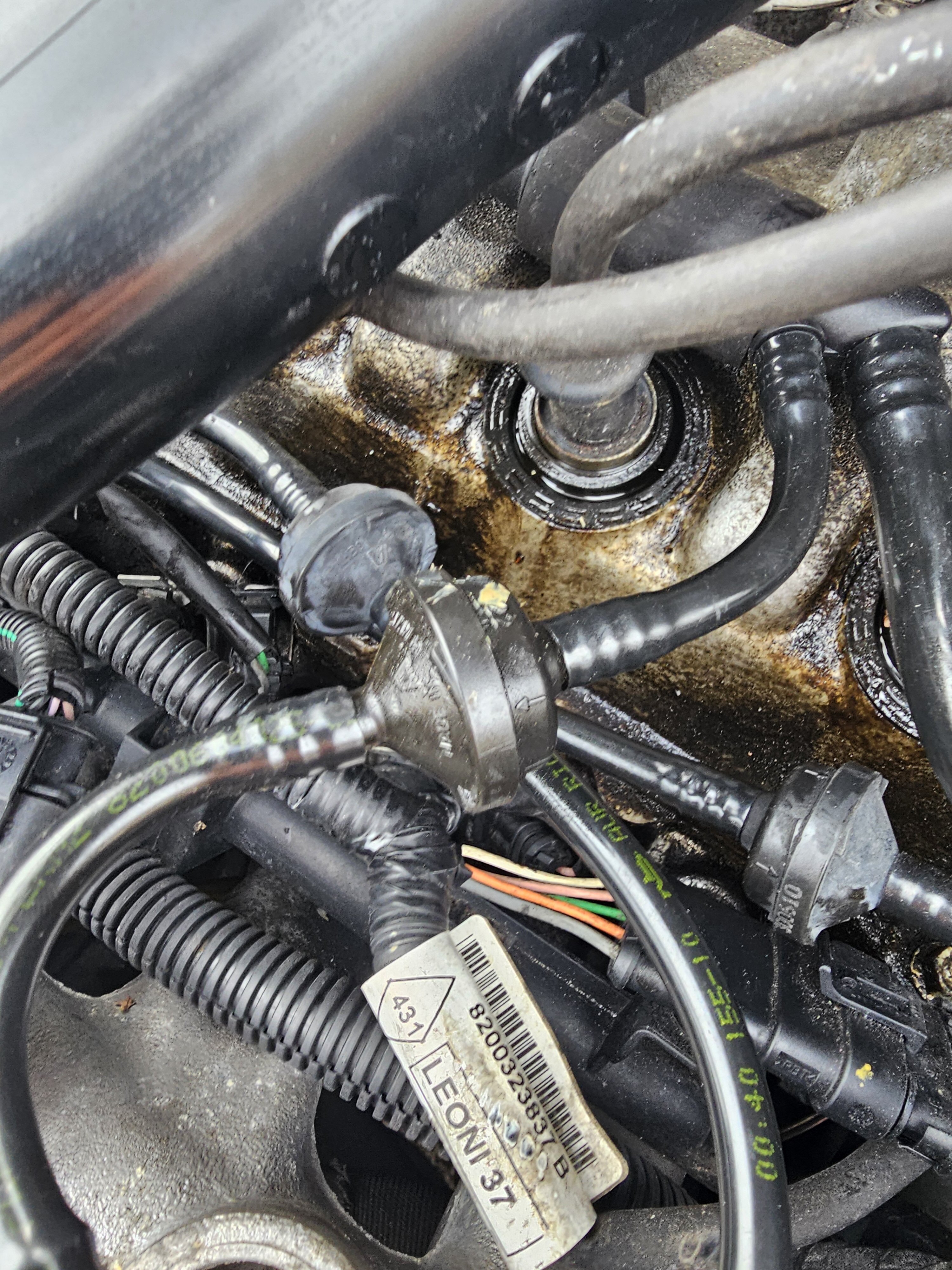

Does anyone know what this is. Got misfire on cylinder 3. New plugs. Coil pack and leads. Still there. Unplugged Injector and engine nearly stalls so I assume injector is OK. But found this. Not sure this would cause a misfire but it needs fixing. Any help would be good.this is the only fault that keeps returning

Looks like a one way valve, maybe PCV/vacuum system? If faulty it would cause a high idle but not specifically a cylinder misfire
Have you tried moving the cylinder 3 injector to say cylinder one and see if the misfire moves with it? If it's not the injectors you may be chasing electrical gremlins

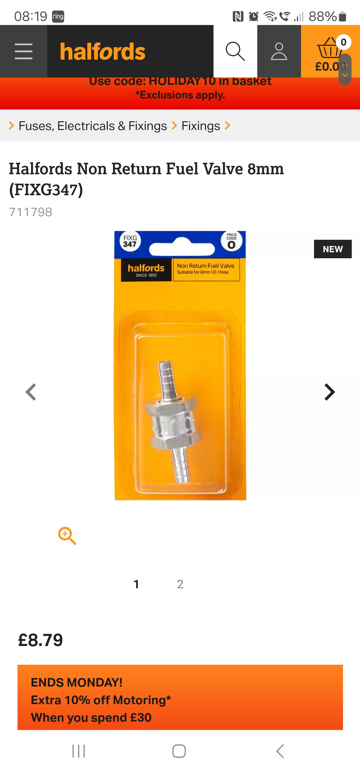

Could I get away with this as a fix
That’s not your problem. That leaking would have minimal impact on anything other than a higher idle.
I use a small vacuum leak to moderate the idle on my turbo’d 182. All the boost pipework makes it idle too low and cut out from time to time and the leak cures it.
I would still like to fix this issue as well. Just wondered if that part would work
