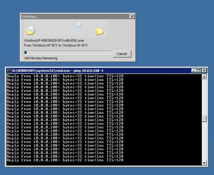

Right chaps - this is something silly and frustrating, that clearly is so obvious that I'm not seeing it!
At one of our depots, we have the typical 100mbps network setup - 10/100 switch in there, a small file server and about half-a-dozen Windows XP PCs. On one PC, I've picked up on the fact that it's still running on XP SP2 - no probs though as SP3 is currently sat on the file server there.
However, when I go to retrieve SP3 from the file server, or go onto the file server itself and attempt to push it out to the PC, the time remaining is ridiculous - as seen in the attached...
Yet, there's no issue with the ping time, nor with the PC when it's being used in its daily role? It seems ok browsing to shares and folders on the file server, but just copying SP3 across is taking forever.
Any thoughts, comments, suggestions, or "You're a plank - have you tried this...." feedback will be more than welcome! ;)
D.

Tried that and it didn't make any difference m8. That said, the Broadcom driver dates back to 2005 and it's being updated as part of the Windows Update. 160MB+ and that is coming through ok...

I'm thinking it might be down to overall distance? We have two PCs (of which this is one) at the very far end of the warehouse for booking in purposes. PCs closer to the comms rack don't any file transfer issues and I wouldn't be surprised if the distance from the comms rack to the 'outer' PCs is very close to the fabled 105m limit on unboosted structured cabling.
This is why I <3 fibre connections. :)
Thanks for the input though guys!
D.
