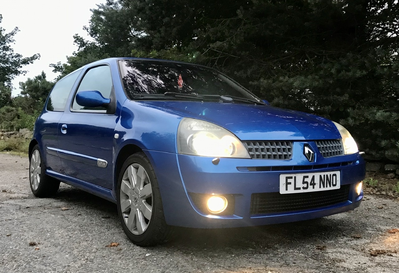

Hi all, just picked up my new 182 and absolutely loving it. First Renaultsport model for me and I’m amazed at the front end grip and the overall agility of the car. Planning a few odd jobs to make it my own but nothing major, just looking forward to using and enjoying the car.

check your bonnet catch, in the pic the bonnet to bumper gap looks pretty big at the nose. in all honesty looks like the bumper under tray to subframe is missing and the bumper has sagged, but these cars are common for the bonnet catch failing and bonnet flying open at speed and basically trashing the front of the car. so worth a check over :)

Welcome aboard, your new ride looks very tidy👍.

Cheers guys. So I know the previous owner and he mentioned that he's not got the alignment quite right with everything after changing the alternator, I'll have a bit of a play to sort it out. Bonnet catch looks pretty well maintained but will keep an eye on it, does the mechanism tend to break or is seizing the enemy? You're also correct on the missing undertray, it's on my list!

the part attached to the bonnet seizes or becomes sticky and doesn't allow the clasp in the slam panel to grip it properly, there was a recall to replace the catch on the bonnet with Renault, but simply brake clean then wd40'ing it every oil service keeps her mint
There are two 'undertrays' essentially, one literally right under the car on the subframe covering the sump etc and then a smaller one from the front of the subframe to the front bumper that acts as a mounting point to keep the front lower lip of the bumper sticking out and the top grill area rotated up to the bonnet leading edge

All understood, cheers for the heads up!
