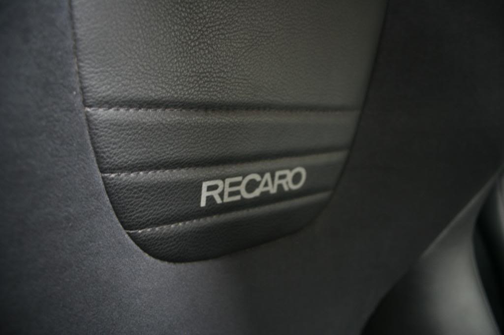

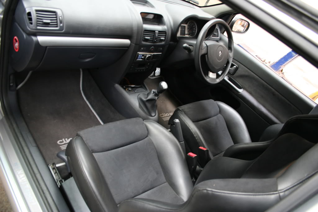

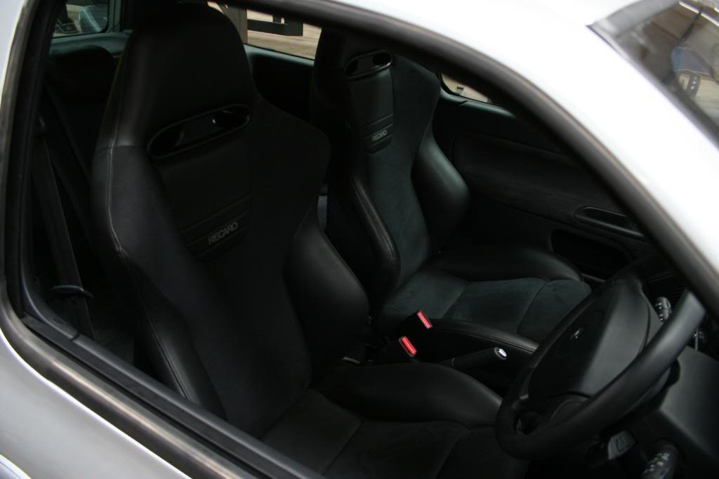

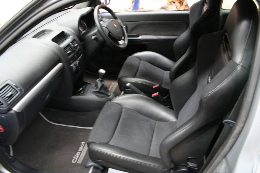

finally got round to fitting them :) poor pics but will be doing a full photoshoot for my car sometime within the next few weeks.

they were surprisingly easy to fit to be honest, having two people helps mind as they are so big and the car is so small lol

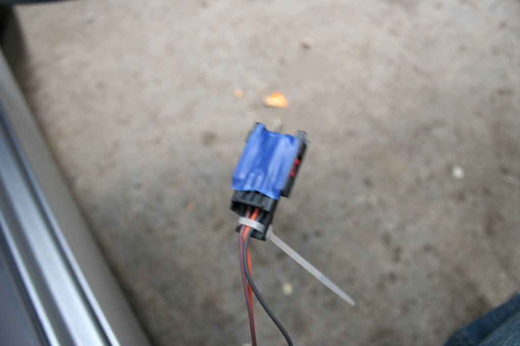

hmm tips? have you bought the resistor kit yet? if not buy a set of 3.3ohm resistors from ebay for like £1 and connect it in the airbag switch from brown to beige and brown to orange (black is earth) saves like 40 quid :)
they are really easy to fit, like i said get a mate to help as they are huge compared to the car so struggle to get them into the car and if you do it by yourself you may scratch the car on the way in. Also check to make sure they tilt forward and move forward when using the rear access handle as once they are fitted if that doesnt work its alot of work to get working lol
