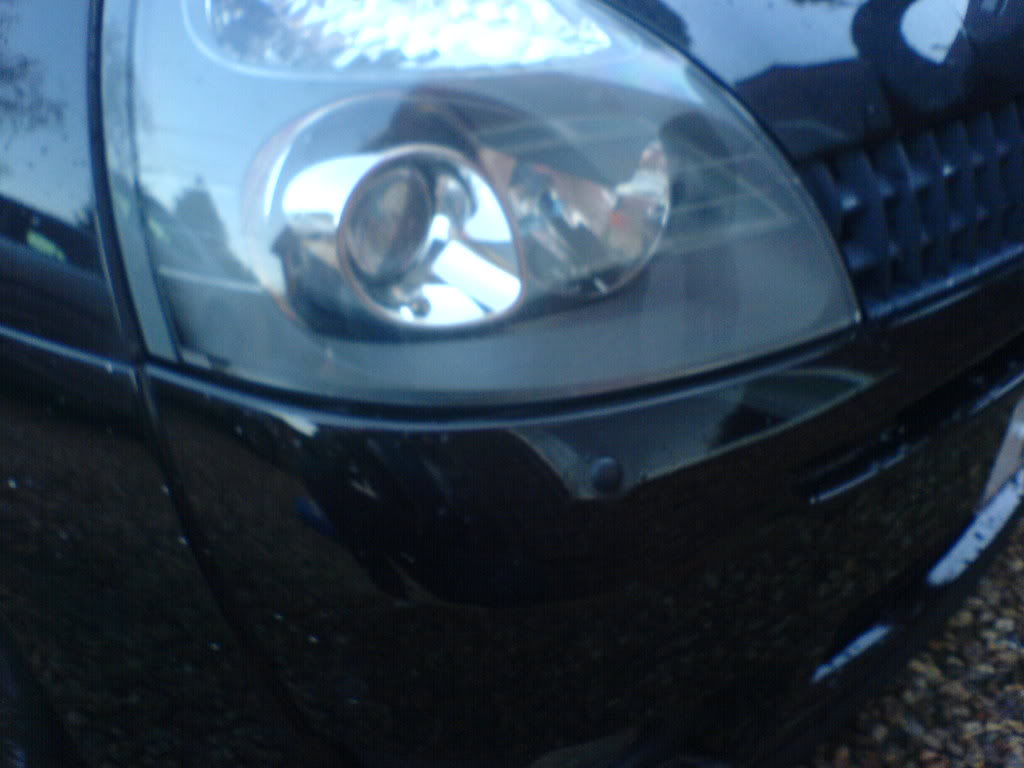

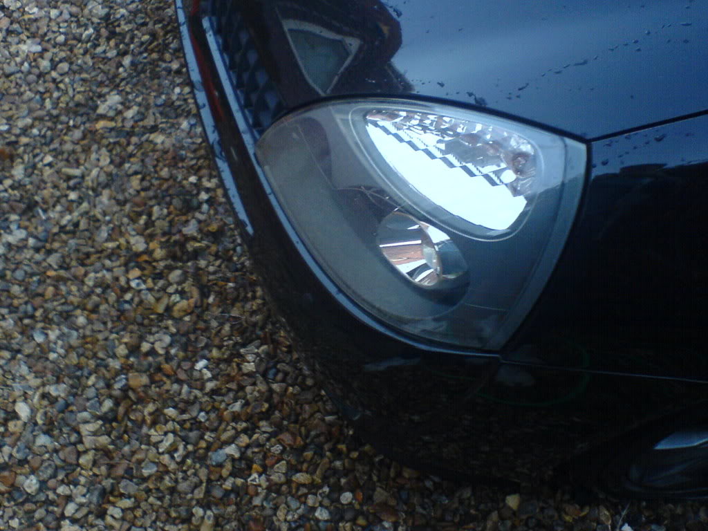

Replaced the horrible renault squirters - I can actually fill the bottle now without it leaking out the washers iugnore the smudges round it thats just my fingerprints
Cost a couple of quid for some grommits which I got off graham172 from here but I think you can get them at halfrauds by the looks of it anyway
Just measured one the diameter is 15mm :)
The tubing has a connector on the nearside where I just unplugged them both, removed the tubing from the bumper and the cable tied the hanging tubes together but bent them so they wouldnt leak if you see what I mean.
Then popped them back into the plastic clip that holds them, job done. No more leakage :)
Oh and dont forget to remove the fuse for the headlight washers they have a different pump to the main one so all is good.

Plus they look pretty "factory fitted" :) only a tiny hole at the topthat wouldnt fill but im not bothered about that
^ More effort than I could be bothered with in all honesty, but no if you work quickly (I work very slowly :)) It could be done in an hour
