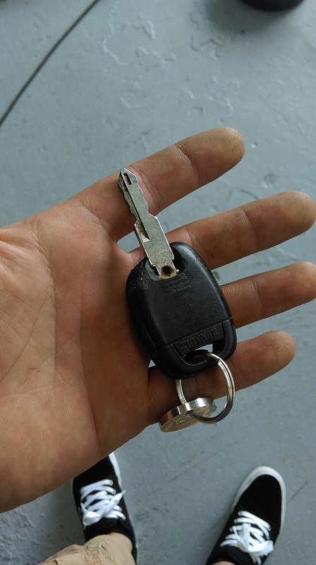

I have a spare case you can have, but you may have damaged the circuit board. Take the key apart and check the pcb, see if it can be fixed with a bit of carefully applied solder.

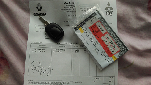

ph1 keys come pre-coded from Renault now, complete with blade @ ~£130.
Just off the phone to my local dealership, they have quoted me £96 for a new "plip" however they then said I'll be an additional £50 for the plip to be coded to the car
I mentioned that they come precoded for the ph1 and he assured me that they only come partially coded but then must be programmed to the ECU. Is that correct?
It certainly didn't happen the last time I ordered a key, it came straight out of the bag and worked first time

it doesnt actually sound like a replacement, more of a repair to the key itself
I've got 1 key which won't unlock the car but works perfectly in the ignition (lock are siezed due to lack of use)
and another key which unlocks and starts the car however every noe and again it doesnt disengage the immobiliser. had this issue before and after a while it just bit the dust and left me stranded lol
