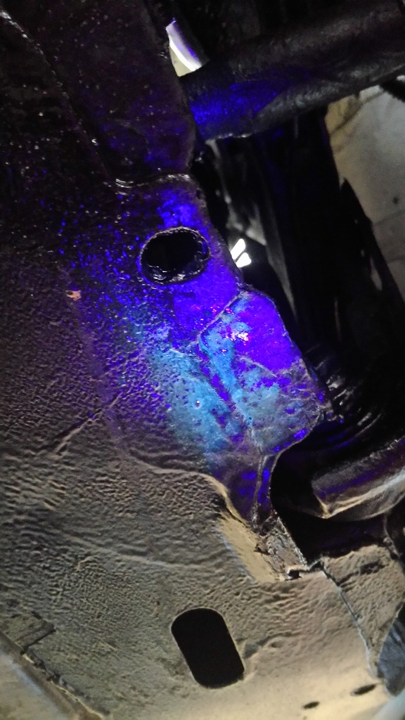

The above is the subframe, where the driver side wishbone is mounted. The UV light is picking up the oil and showing it up as green.
So attempting to go upwards:

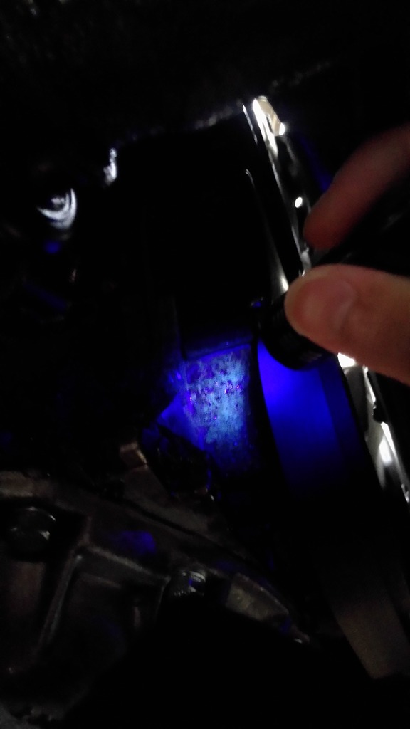

This is the crankshaft pulley, and the block has loads of traces of an oil leak.

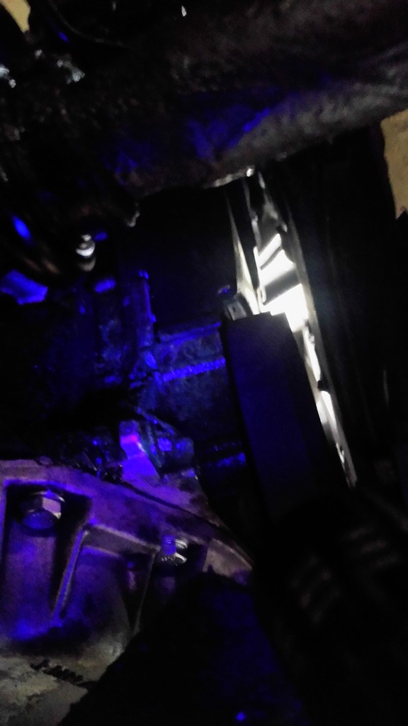

This is where it gets really difficult to see, where the plastic cambelt cover is, there's loads of oil on the outside of it, but I can't tell if there is any within it.
What makes it much worse is that this oil leak is trickling onto the driver side driveshaft, and presumably once it's on there, spins and flicks oil everywhere, so it reaches as far as the steering rack gaitors and even the fuel pipe underneath the car. It may just be looking worse than it is, but I have put in a litre of oil over about 500 miles.

I can only assume it is either of the camshaft seals, the ones I've replaced alongside the cambelt and stuff.
Either I've cocked it up, or the rocker cover itself is also leaking. I don't think the plastic cambelt lower cover would be showing signs if the crank seal was leaking too.
I want to believe they can be changed in situ, but is this a fools errand? Taking off the RH engine mount didn't reveal anything, so I think the Aux belt would need taking off in order to remove some of the brackets to allow the middle to be taken off. Even then, I don't think there's enough space or clearance or slacken the tensioner and thus slide the belt off the pulleys. Then try to take off the pulleys and sort out the cam seals again.
