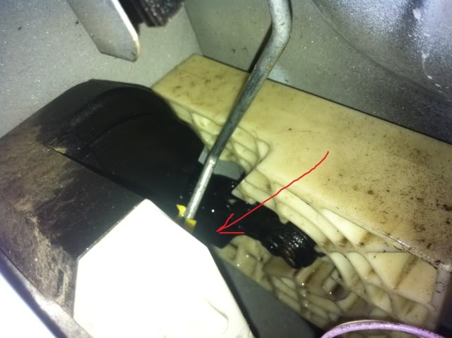

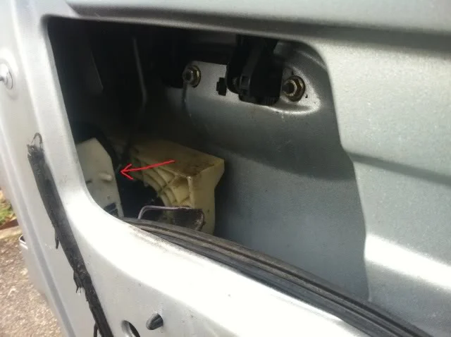

I took the doorcard off the Driver side to see for sure which bit "controls" the Central Locking and its this White Box..
There is a plug that plugs into that white box with a White wire and Purple wire that you can see in the 2nd and 3rd picture.. I've taken it off and had a look and there doesn't seem to be anything wrong with it..
Does anyone have any ideas of what I can do next to fix the problem? I can't even see how you'd get that White Box out to replace it!

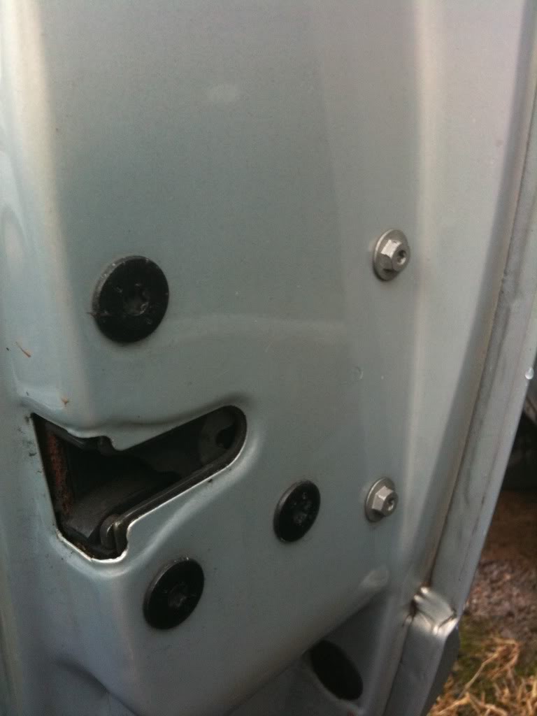

Mainly you just remove that white plastic thing, it's just protection, (the bolts are on the opening face of the door itself).
You need to clip the metal rod out of it, and you're away.
Here's what you need:
The two little bolts remove the white plastic thing, the large three torx heads get the actual locking mech off.
Each mech contains the cable that unlocks the door and the rod iirc, you just have to re-attach the rod to the exterior door handle.

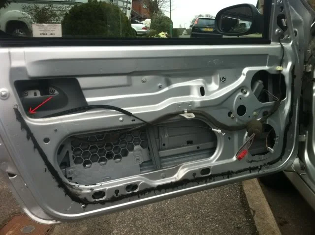

I had the same problem when I replaced the exterior door handle on my car. Even when I locked the door using the remote key it would still allow the door to be opened.
Solution (for me): remove the door card again and check the upright metal bar that connects just to the left of the door handle (on the inside), mine was too low (or high, I can't remember. I unclipped it (easy, just push it away from you then to the left) and re attached it againat a different height. Checked it again and it worked correctly.
