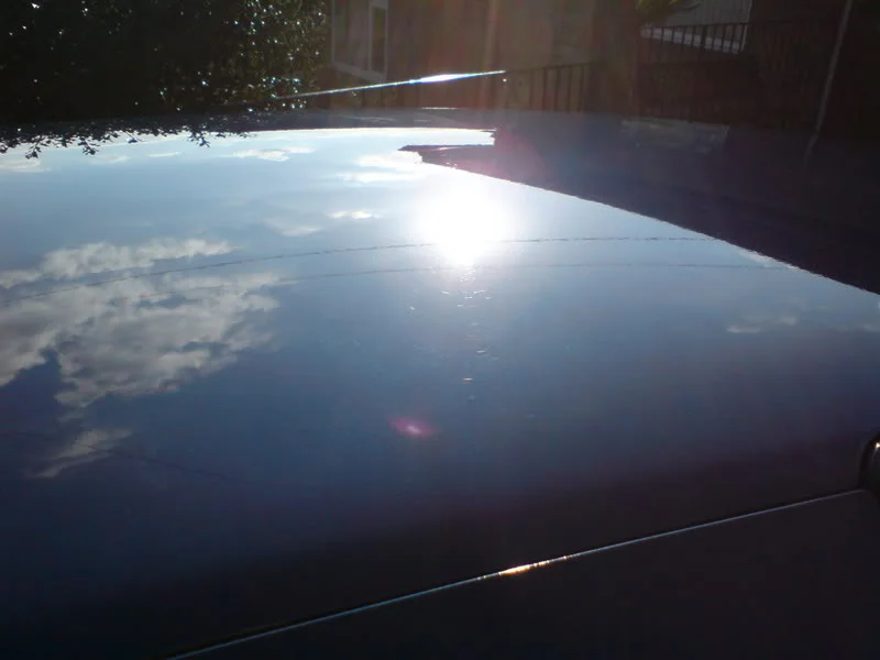

I've done a decent bit of PC polishing now, and from what my car was, it looks loads better than it did. I've now decided that I want better though, as it's i'm sure I can do better.
I have been using the Sonus pads, 6" and 4", and SSR1 & SSR2.5
I've used the yellow (restore) pad with the SSR2.5 on the worst places, but it just doesn't seem to get rid of all the little swirls, they really are feint marks, so they should vanish
The pic doesn't quite show it up well, but that was after a good polish :
........so, what do I move to next for a better job
Cheers
Andy
  RB 182
Sounds like you need to do more passes, I had the a similar problem and was told the number of passes needs to be about 10 (depends on the polish).
  Monaco 172 2/468
Ah right mate, so how long should it take to polish a roof like that then, normally takes me 1-2 mins per section to work it in. Would probably do the roof in quarters

Christ!!!, it takes me AGES to do a roof (properly ;)) After spreading the polish round (roof made into 1/4 sizes) i move the unit around 2" a second, and usually make around 10 passes or so with the menzerna range

I split a roof into approximately 6 squares and work a square at a time. A family saloon roof takes me approx 1hr 30 mins - 3hrs depending on size, level of defect correction and paint type.
I start at speed 1 to spread the polish, 2 fairly quick passes
Speed 3 for approx 6 slow passes
Speed 5 for approx 4 slow passes
Speed 2 for approx 6 slow passes
Speed 1 for approx 4 slow passes
You should get a great finish from this procedure
You may want to invest in some Menzerna IP & FF polishes or Megs 80 & 83:)

Your pads are fine mate and to be honest your polish is fine too.
You just need to work the product for longer to get the full potential out of it.
I would start with the least abrasive pad with the 2.5 and step up the pad if this does not do anything.
Then use a clean less abrasive pad for the ssr 1 to finish, where I go down to speed 2 in the above process
Speed 3 for approx 6 slow passes - SSR 2.5
Speed 5 for approx 4 slow passes - SSR 2.5
Speed 2 for approx 6 slow passes - SSR 1
Speed 1 for approx 4 slow passes - SSR 1
  106 GTi
Poorboy SSR's would aswell as the 80 and 83 though don't get the level of Gloss the Menzernas do, but will correct defects. Don't bin the SSR 2.5 off it works well.
As said above more passes, enough pressure that the machine does not bog down. Work the SSR until it almost starts to dust you will know it is worked enough then. I always do the bulk of the polishing at speed 6.
Ditto! After spreading the polish and steppin up to speed 3 for a number of horizontal and vertical passes i'm straight onto spd 6!
