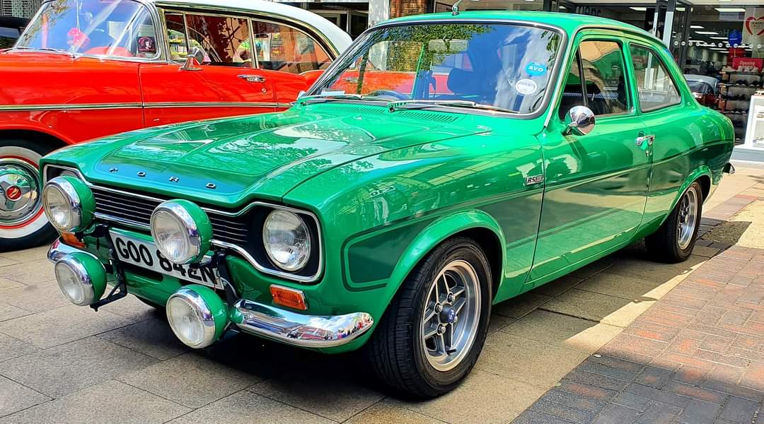

Ok, thanks. No idea if it reads the power steering, I just bought one with good reviews off eBay. Plugging things into cars is all new to me, this is what I'm used to working on. No computers here!
Sounds like I need to take it to the garage then to get it plugged into a big boy computer.
