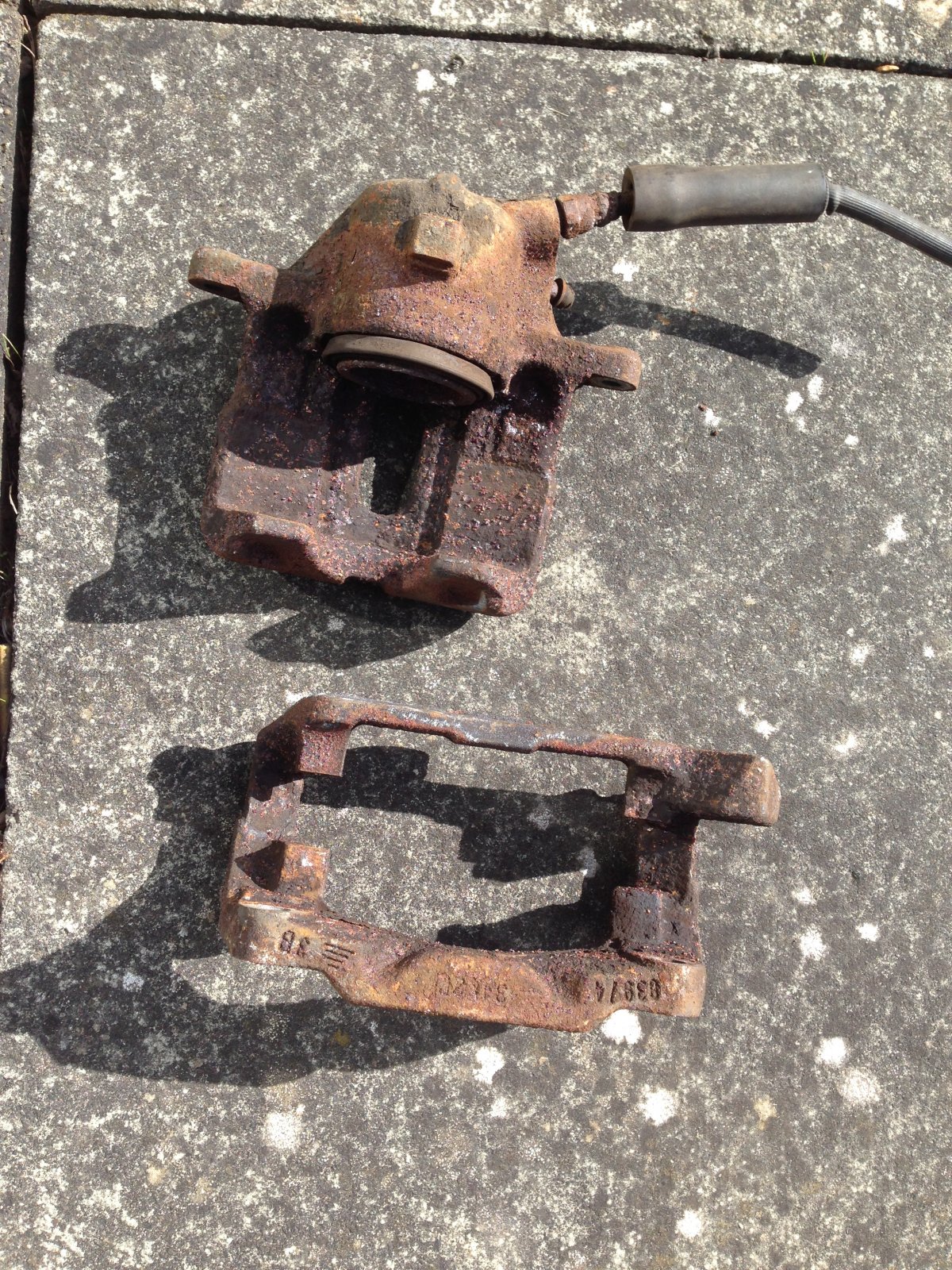

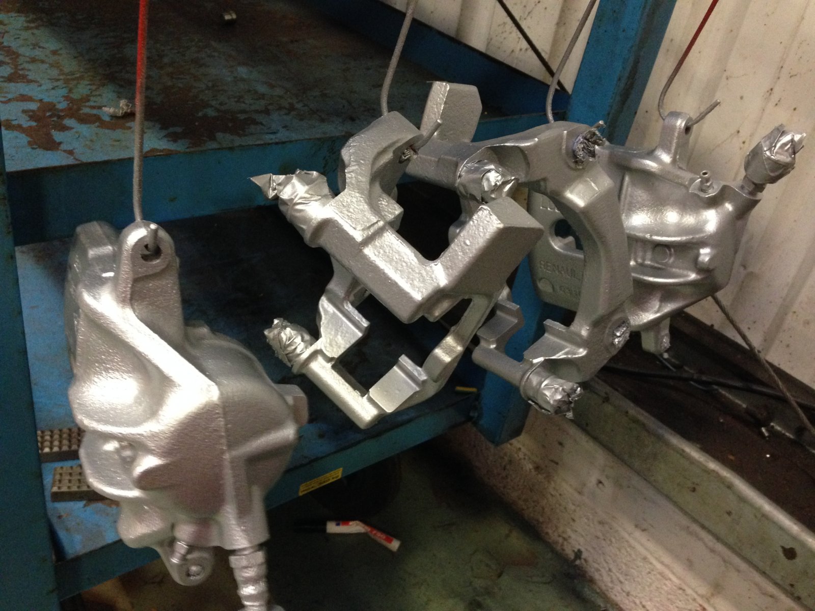

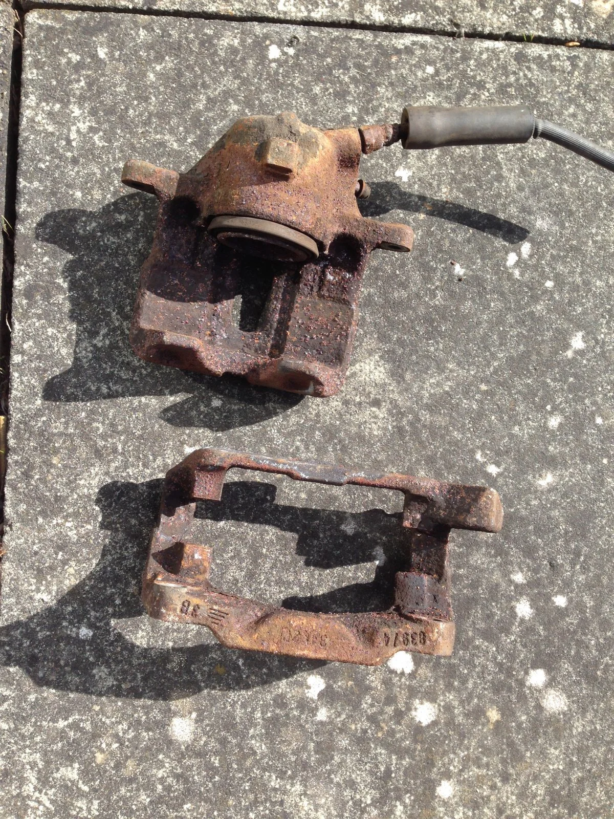

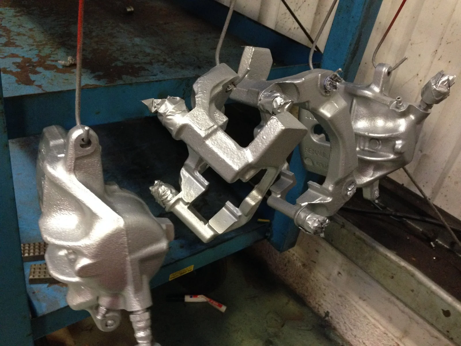

Here's a nice before and after of the calipers I bought.
Just got to build them now. I only realised today that the wheel actually pulls to the right as the car squirms left under braking. Had convinced myself I was having to steer into it myself but tried some braking with almost no grip of the wheel and it's clear as day.

Bought a set off ebay for £25 and did them myself. Didn't have to take the car off the road that way. Got seals and parts from brakeparts and biggred.
I only did them myself because of access to tools and equipment at my work. One of the nipples had been rounded and it took a couple of attempts to get it out using oxy-acetylene it was that seized, I'd have been pretty miffed if I'd only been able to do them in the house!

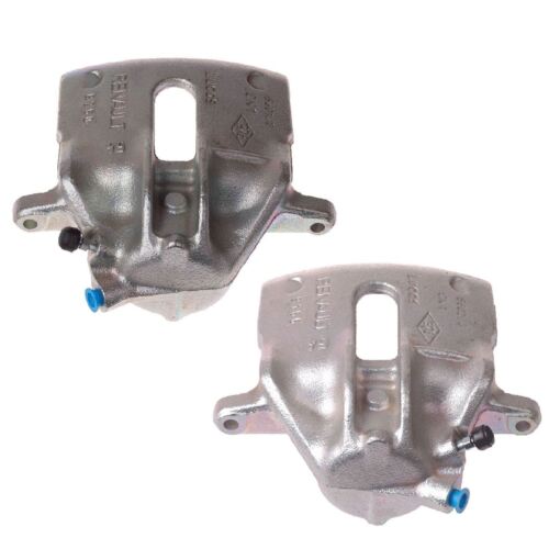

No longer have the same capacity to carry out a refurbish myself so thinking I might go with these-
hopgop1
I've got a set of OEM calipers from my 182 that would be ideal for sending off for a refurb if you wanted to go down that route. It's what I did with mine, sent to SSL and very happy. Mine were just looking a bit worse for wear and one rear caliper was a bit lazy (probably sliders).
Either way I'd definitely want to stay genuine where you can, those look decent.
