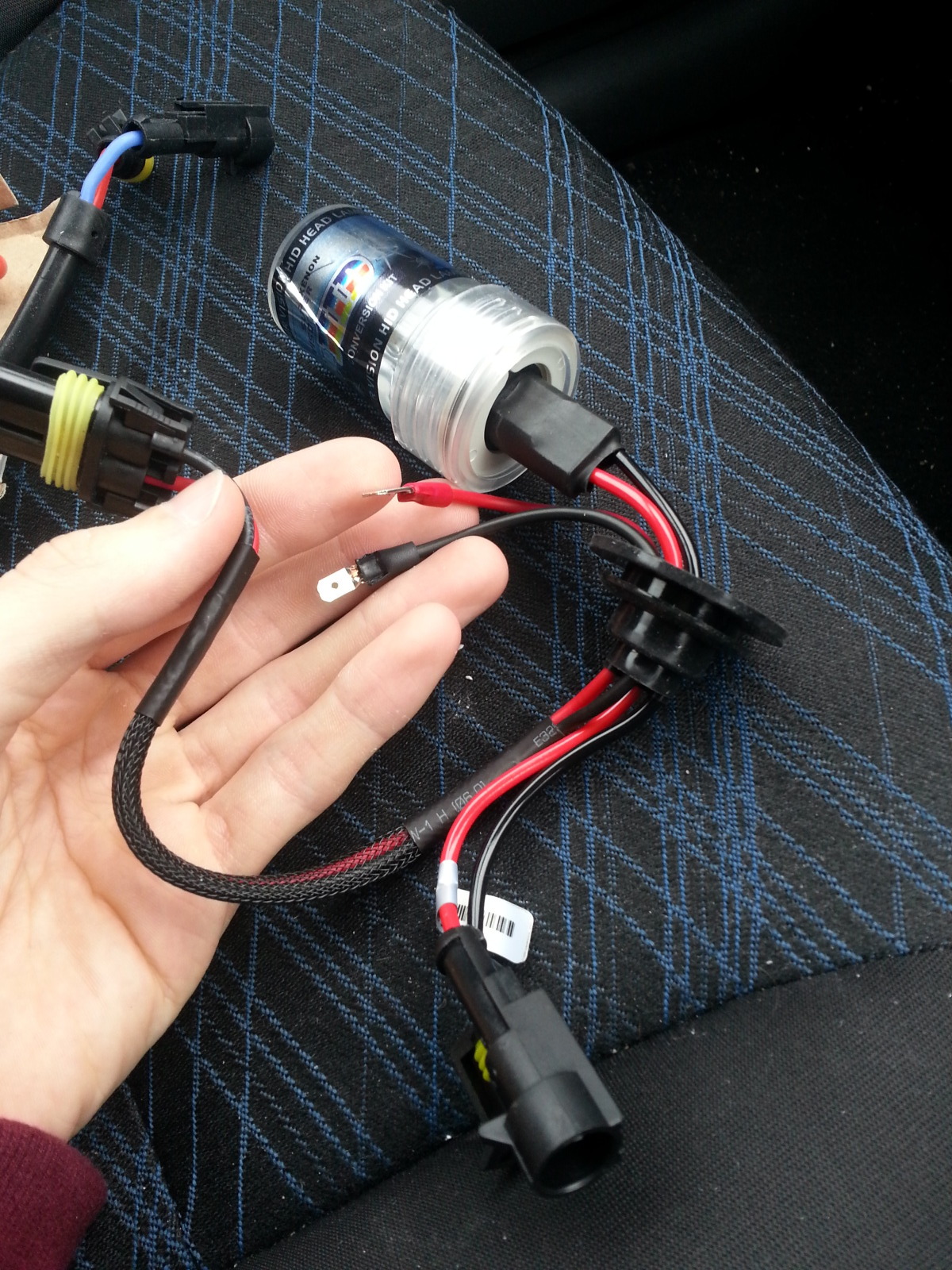

The plugs on the chair go from bulb to ballast, what's the others in my hand for? It goes from the plug in my hand to the tabs in my hand?

Amos91 Chrisgti6 yes I have projectors :) hate people who dazzle other drivers with incorrectly fitted HIDS! I'm assuming those connectors are just spares really? The bulb has the two wires that come out with the plug sitting on the seat, that then fits perfectly into the ballast plug and the ballast has a plug that goes into the cars bulb holder. Correct?
Not sure if those other two wires could be for if you use a different bulb/ballast choice? It was all as a kit! No instructions though in the box :(

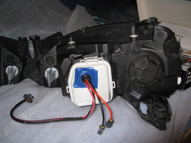

Some headlights are completely sealed, with the bulb and power connector inside the sealed unit. But of course the ballast wouldn't fit inside the unit with the bulb so you'd drill a hole for that grommet in the cover and mount the ballast outside. But it doesn't matter for the Clio as the bulb connections are outside the sealed unit anyway.

Don't think you get what i mean haha, look at the first post photos. There's four wires going through the rubber grommet, I get where you put the grommet etc and know you have to drill a hole in the rear dust cap on the headlight that the grommet then goes into (been looking on 197.net). What I don't get though is there is four wires going through the grommet, four coming out each side, two go to the bulb on one side,and the ballast on the other side, but as you can see from the pic this leaves two spare wires which as far as I can see serve no purpose at all?

Those two in your hand in the photo plug into the original non HID bulb holder to provide power to the ballast.
  1.6 Astra Sporthatch
That's the one on the seat, theres two cables in my hand, both don't go anywhere at all its just that plug in my hand leading to the two pins in my hand, nothing on either end.

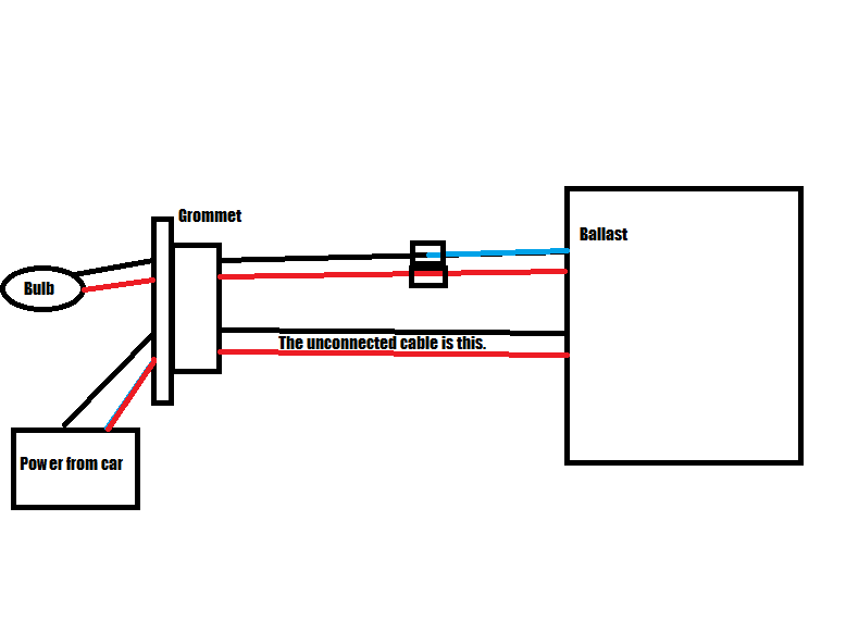

But if you can connect the power connector directly to the ballast then you don't need the other cable.
Thanks for that excellent diagram! That's basically the cables I have on the chair leading to the bulb, so that diagram doesn't involve any of the cables in my hand and can be made purely with the cables on the chair, so I'm guessing the spare cables there must be for other bulbs/ballasts or something as they're just spare really... confused me a bit haha wondered why they'd be spare on a kit but now that's cleared it up for me with that diagram :) I can make that whole circuit and somehow have those cables in my hand left over :s
edit: so is that spare cable basically an extension to allow you to put the ballast inside the headlamp unit/the other side of the grommet on some cars?
edit: im a noob I understand now I forgot power obviously came out the headlamp into the ballast

How on earth do you think the ballast gets power??? The two spades plug into you original H7 bulb connector....
Seriously, did you think they're powered by fairies?
Nope, thought you'd take the wire out that connects into the bulb and plug that directly into the ballast. Didn't think there'd be an extension and assumed if there was it'd have a plug on both ends not two spade connectors
  2003 Clio 172 Cup
luckily the connectors are all pretty straightforward and only plug into each other in the correct way. They only use the spades because that's the most straightforward way to cover all H7 plugs.

That's the most preferable option. But if you can't get the connector to the ballast (because it's sealed behind a cover), you can use the extension and cut the cover.
E.G. the Corsa C needs the covers drilled.
Ah I see, I'm going to keep the rubber dust caps on the headlight and drill them, then use the extension cable then to keep the dust caps, I was planning to just get rid of the dust caps and plug the ballast straight into the headlight connector, hence the confusion!
