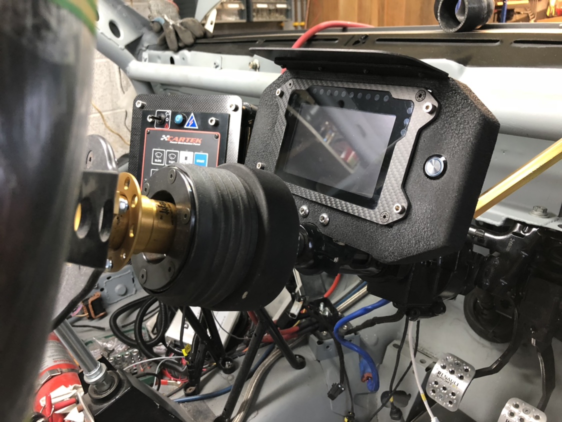

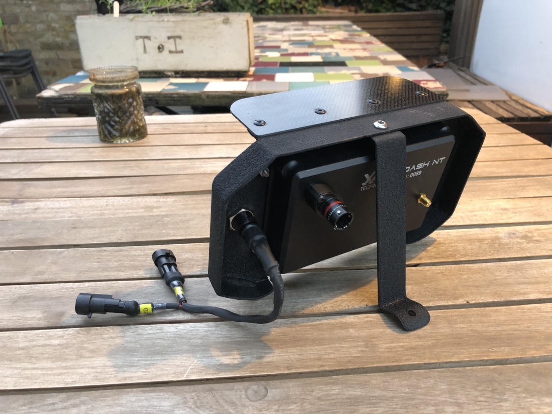

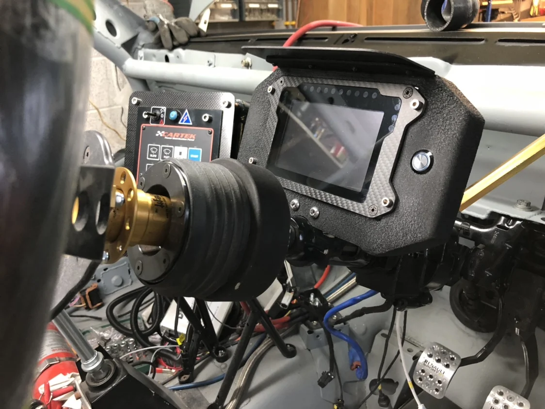

I have DTA NT-Dash in mine. Very happy. Fully customisable. Not the cheapest out there.
Mine has GPS and data logging.
But that ADU by ECU MASTERS does look sick! Good bit of kit!

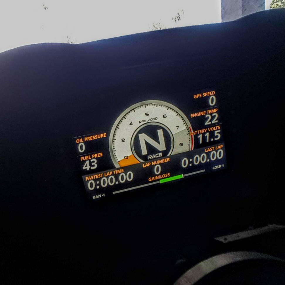

Im using a motec c187 reace dash, connected by canbus to a emtron ecu.
It downloads the data so you can do the same annalysis very quickly as a proffesional race team. However compared to development time with no accurate tools its extreemly cheap. nvm
And.. it looks super cool.
Unfortunatly it cost me more than the car did originally.[emoji23]

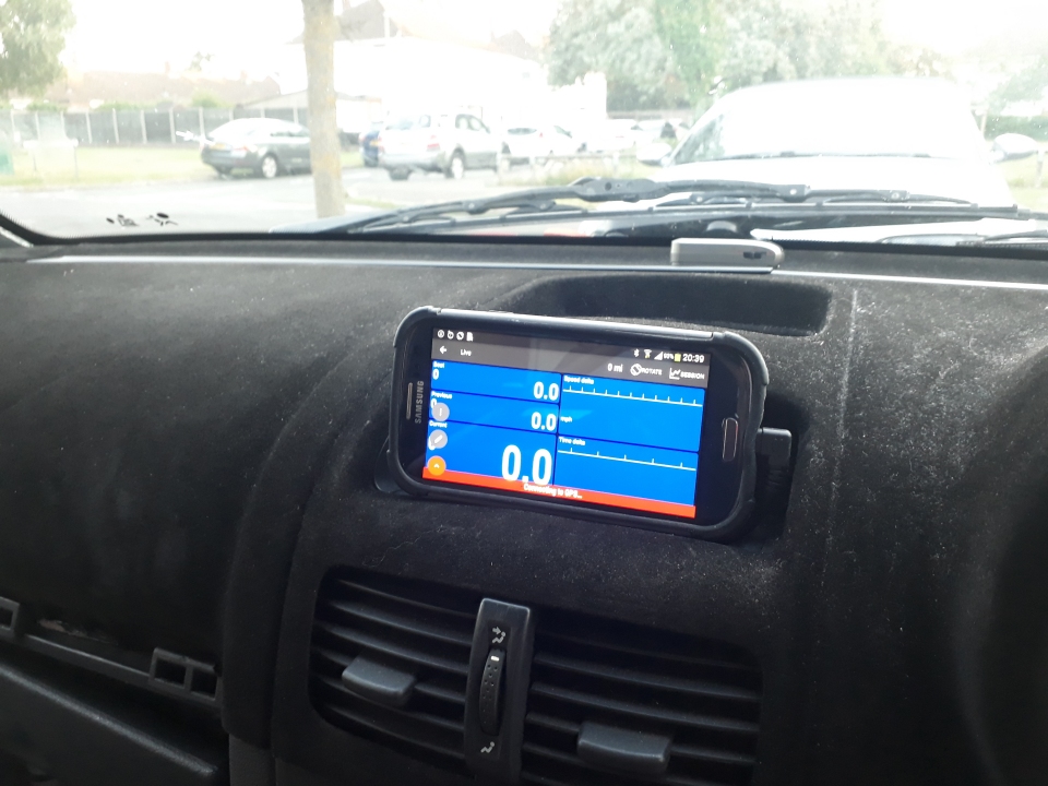

I'm running a RaceCapture Track on a Gen90. Cheap, £280 delivered. Doesn't include a dash but you can use your smartphone which I do - not had it drop out once. Connects to ECU over CAN. Does all the logging, which you can export to 3rd party software (I use TrackAttack as it's pretty much the only free option for Mac - Can overlay GPS trace and Video to analyse racing lines). Comes in the box with 50hz (smartphones are 1hz) GPS, accelerometer, and OBD cable if youre running standard ECU.

My only addition is a phone running a 10hz gps and racechrono so I can see the predifive lap timing.
