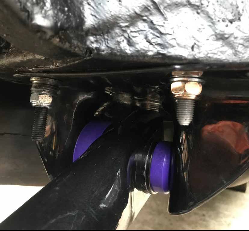

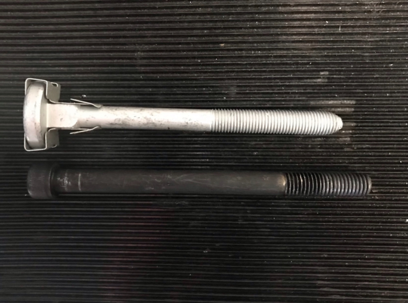

When I first replaced my rear beam, I bought some bolts from Cromwell to save money. Unfortunately, these bolts didn't have enough thread, so I had to temporarily use a bunch of washers until the factory bolts arrived. See the attached pictures for reference.
Aftermarket bolt on the left with a lot of washers. Factory bolt to the right with single washer.
Factory bolt and aftermarket bolt side by side.
In hindsight it would have been easier to walk into my local fasteners with the original bolt and asked them to match as close as possible. Buying online can be more difficult.
